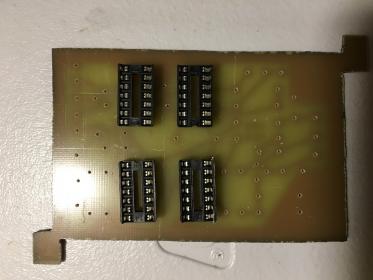

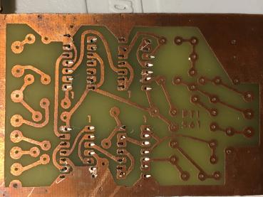

    Can’t forget the good old days of making your own PCB with a laser printer and an iron ( yes I know you all still probably use this method). I’m going back in the past and my son and I are building a old ETI 651 BFO from scratch. He was wanting to build one from a kit as I have but since he is just getting into it I wanted to do it from scratch. Unfortunately the old plans are pretty rough probably from over coping, but I managed to make a descent board. (Wasn’t easy). And I drilled the holes out free hand with a drimmel drill so my holes where pretty uneven but I managed to get the 14 pin sockets in place for the IC but haven’t solder them in yet.
    I personally have built several PI kits from silver dog on a premade board. But this is my first made from scratch MT. And I wanted to share it with my son.

      that's really great, what you are doing. If you have any flux paste, you could tin the board.
      If the copper where the holes are meant to be didn't etch away, as is sometimes the case, I use a small nail and hammer(small) to punch an indent so the Drill bit doesn't drift around.

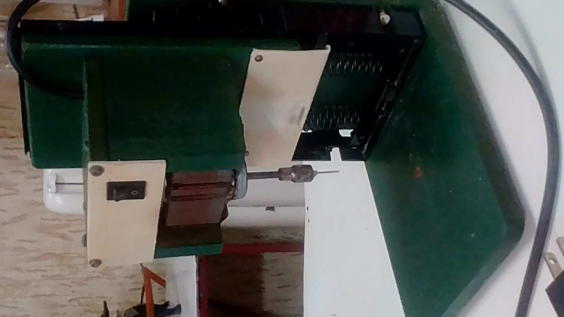

          I even made my own drill gizmo thing

                          Thanks all, I have made small boards with a sharpie before but they was very minimum use boards. Built several kits with premade boards (PI’s) This was the first real board, if you want to call it that, mainly to teach my son and to try the set up out to make more complex boards. Hint- I found that HP presentation paper works very good for transferring the toner to the copper and I used muratic acid and peroxide (40% stuff) to etch. Only took about 2 minutes. Now if the thing works lol. What would be the pinouts to test with a oscilloscope to test if neeeded on the ETI651? Thanks for all the help and comments.
