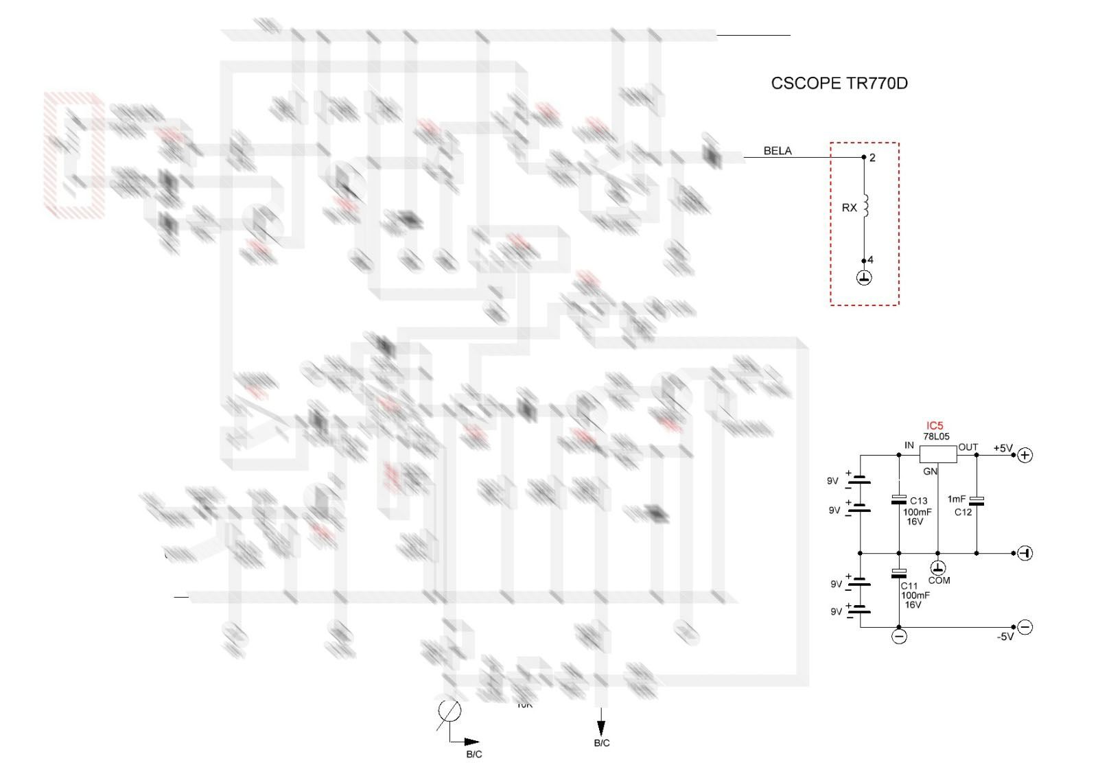

    Hello all
    I was reading a Cscope TR 770 schematic for an repair. On the schematic the 4 9Volt batteries were in series, 2 x 2, but in the Detector in parallel. I know from school this is not wise to do. The technicians from Cscope are no fools, but why this?
    Leendert
    Guess they needed 9V . 4P (Parallel) provides more Amp Hours.
      no data on this detector breeds speculation.
          Yes this is the schematic i used, batteries in series, but in the detector in parallel.
          Strange, and this is the third machine i had in repair with the batteries parallel.
            If the schematic is right, then there is no way they can be in parallel in the circuit.
              a lot of old cscope designs use 2 9v or 4 9v cells, in the case of two cell units, one battery provides 9v+ the other provides 9v- thats how they work old tech but functional, the 4 cell units work the same way but but use 2 cells in each "bank" to give more oomph!.
