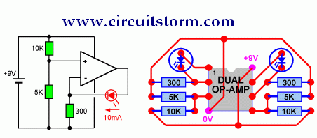

Hi all,,,,I found this little 'Op Amp Tester Circut' and thought it may be of interest to someone. I've only used it to test NE5534 but I assume it's able to test other Dual op amps although I haven't tried others yet. Best regards,,,Marty
Dual Op Amp Tester circuit
