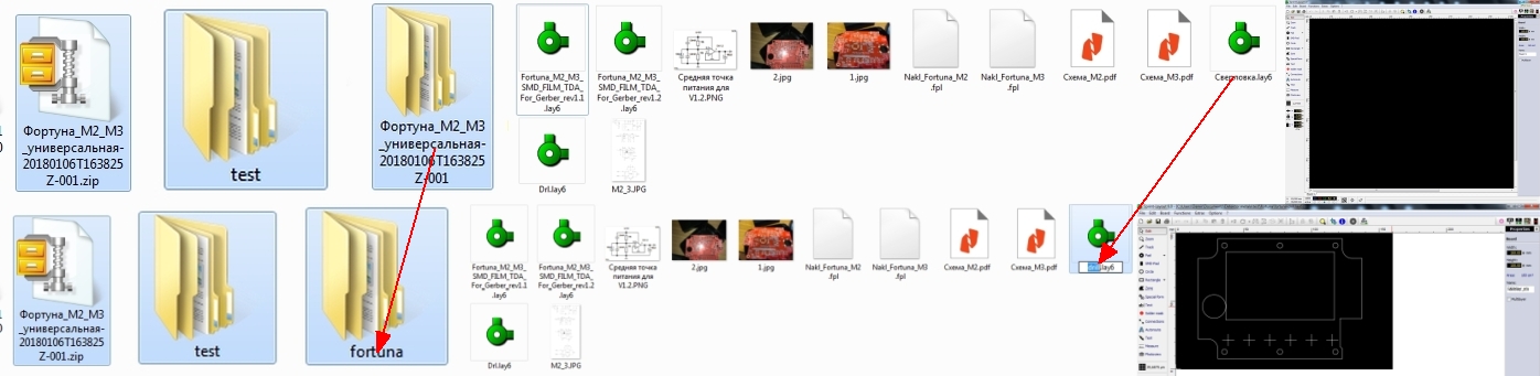

    Hello sometimes i have problem with sprint layout files from russian or cyrillic sites.
    Files contains something but if i open it the pcb view is clear, not tracks and parts to see.
    I read long time ago how to open these files, as i remind the problem was somewhere in the settings or in the language settings and pathes in the settings.
    You know what i mean?

      For me, this problem occurs when a SL6 file is created with a higher version of Windows than the one I use.

        you have to change all the Cyrillic names in Latin
          that was the hidden trick, was not sure, many thanks
