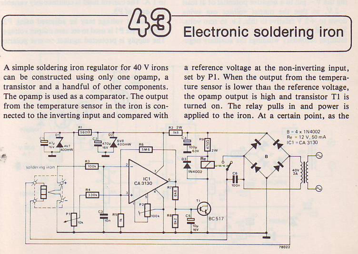

Found this circuit.
Electronic soldering iron
@Dpbanner,,,Hiya DP,,,Have a look at this link and let me know what you think,,,it's an Atiny 25 or Attiny45 Micro controlled soldering station,,small components parts list and really tiny,,,thought it may interest you. I've made a Sprint layout of the PCB for it but I need some one else to check I've done it right before decide to build it. https://www.zl2pd.com/SolderingStation.html Regards,,,Marty
