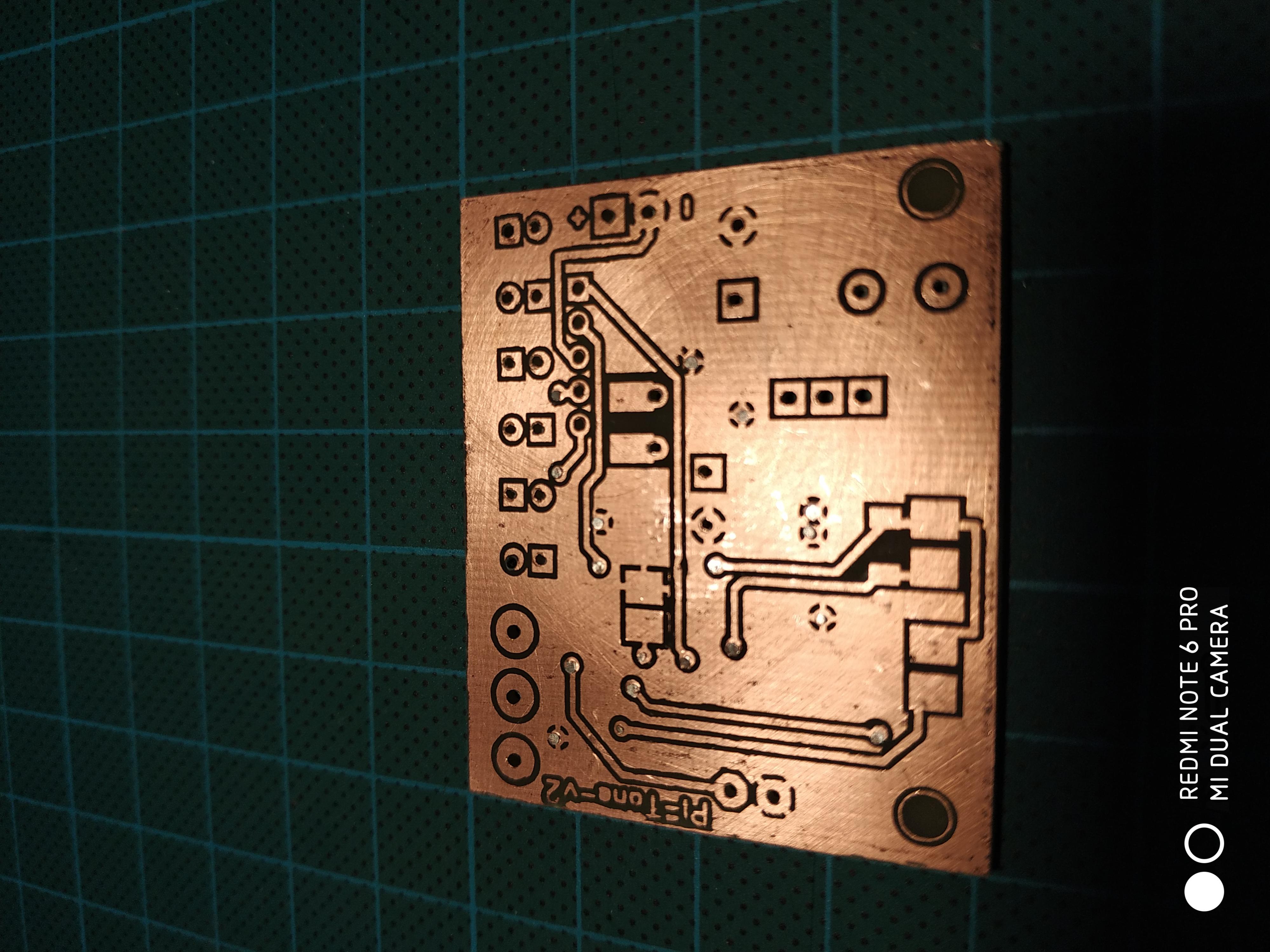

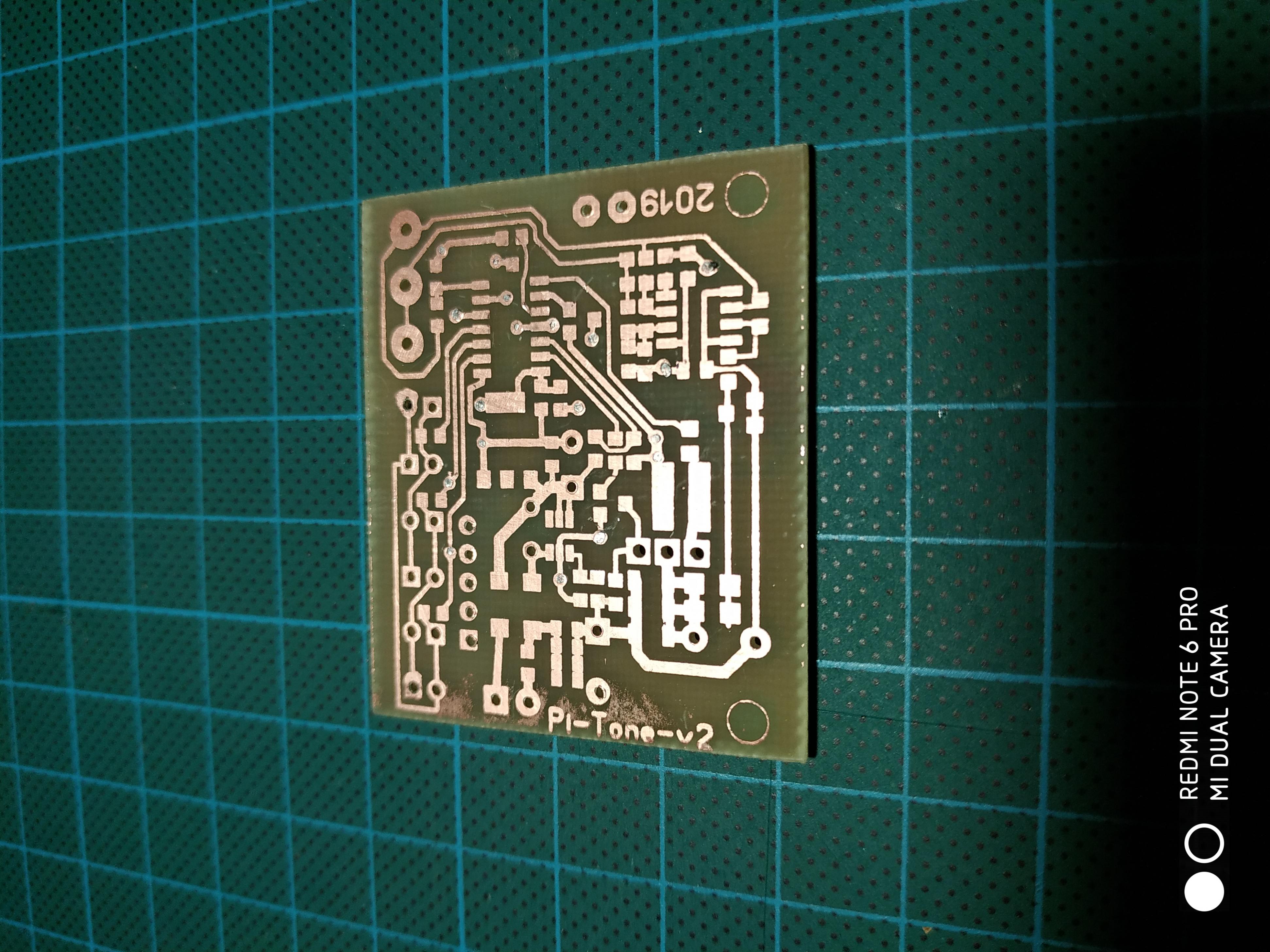

                I use ordinary foto paper, transfer with iron. I will give it a try the cold methode, with acetone as well.
                Here my attempt yesterday, etching was a bit to short, but it works.
                Vias are made with blank wire, flatened with small hammer.
