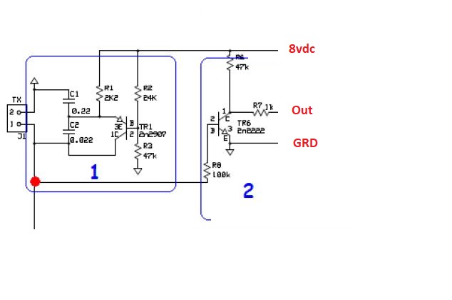

                Some time back I built a mock up of the TGSL tx circuit to test coils. I can do the same with it. Click image for larger version
