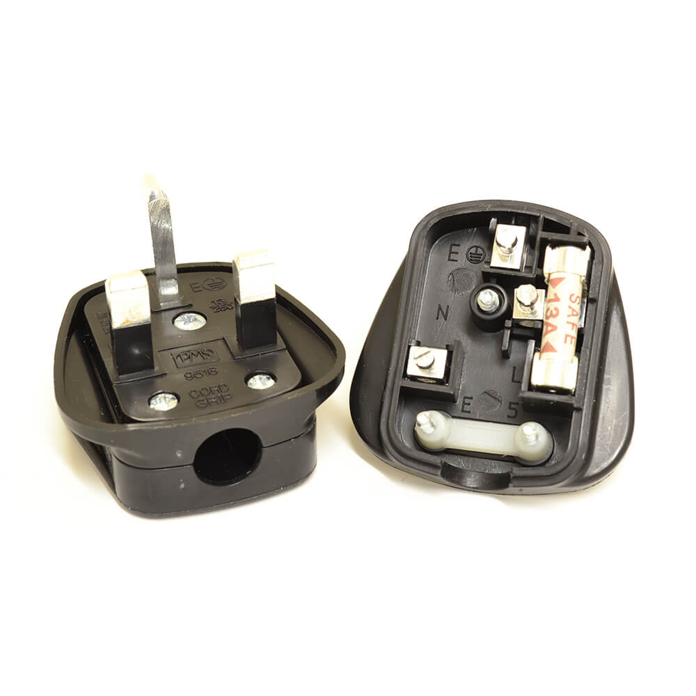

                Possibly, but I think keith777 is located in the UK, and we have mains plugs with built-in fuses. If I read post #3 correctly, it was the fuse in the plug that he tested, not the one located in the mains socket. If he's not in the UK, then I've got that wrong.
                  Oh, I didn't realize that. Yes, the IEC connector also has a fuse.
                  Edit: As Polymer says, it's a 1/2A slow-blow type.
                    I also thought that he checked the fuse inside the plug that goes into the mains socket in the wall. The UK and many other former Commonwealth countries have this feature.
