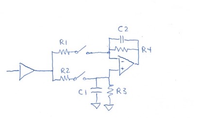

    Hi All. I'm trying to get my head around the humble AC integrator.
    As far as I can see, it's really just a low pass filter. So when people refer to the "number of samples that are being averaged" by the integrator, I am at a loss to fully understand.
    The corner frequency (fo) is 1/(2piCR2) where R2 is the bypass resistor, and C is the bypass capacitor - both across the Opamp output and input.
    So, if R2 is 120k, and C is .1uf, then the corner frequency is 13.3Hz. Does this mean that the integrator is taking 13 samples per second? What about all the other samples in the cut-off band after fo?
    Some help would be appreciated. Thanks in advance.

        I think you're getting confused between a simple integrator and a sampling integrator. The sampling integrator includes a gating circuit (usually a jfet or a bipolar switch) that synchronously demodulates the incoming signal. Hence the reference to "number of samples".

          Okay. I meant an integrator with a gating circuit before it. I've looked through the myriad threads kindly suggested by 6666 (and the referenced sub-threads), and haven't yet seen a formula to calculate the number of samples per second for the attached example circuit. I'm not worried about calculating the gain of the integrator.
            Not simple----best is Carls post that goes sample by sample to calculate integrator output.
            Setup a spreedsheet with the parameters: Cs,Rs, pulse rate, Sample time, etc. Then calculate the output at each sample time.
            Plot this to see the time response to an input step.
              R4 and C2 set the response in your circuit. Sample rate(Tx rate) and sample time effect the gain.
                Or simulate it with SPICE.
