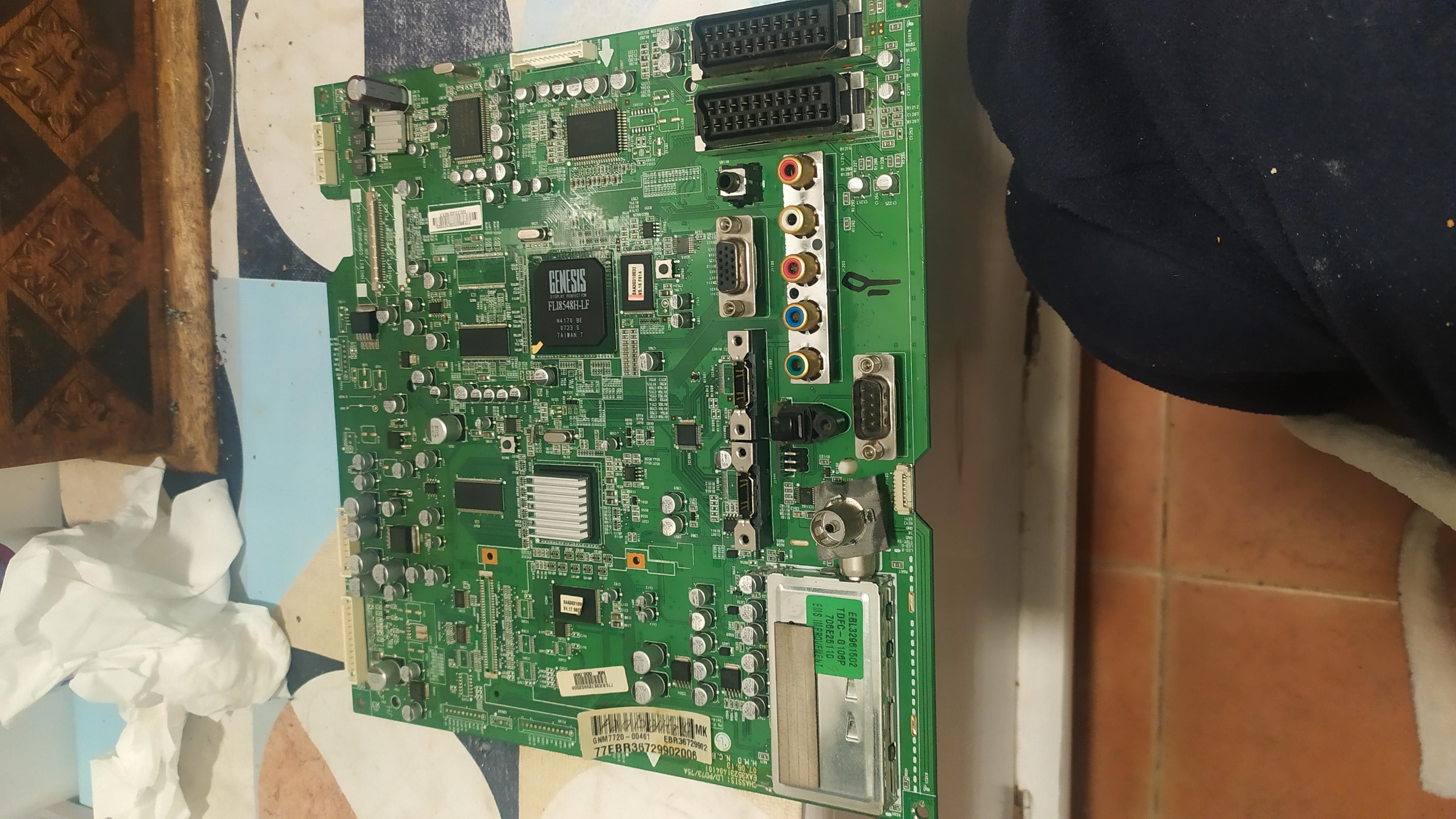

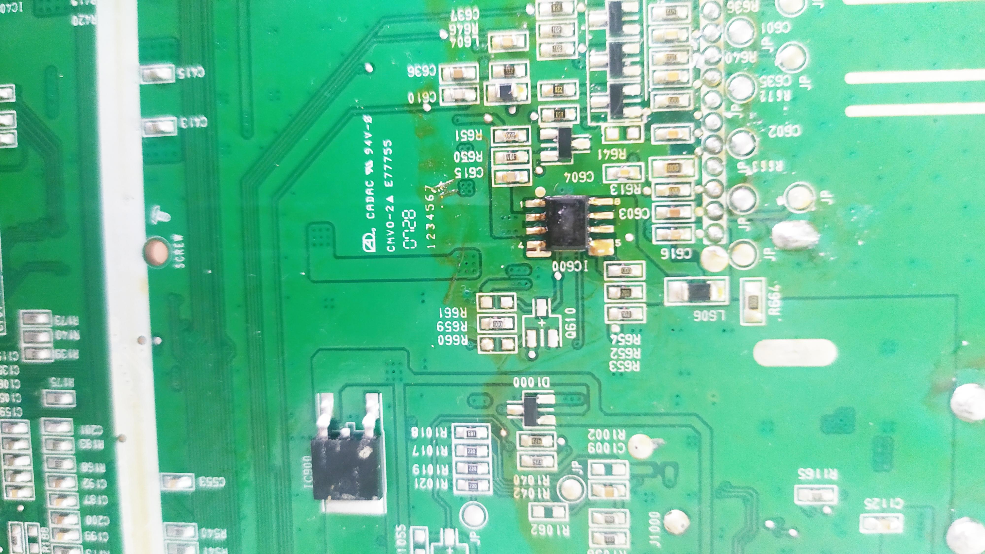

    Hola tengo una placa la cual tiene ic inchado y no sebe bien ,quizas alguien sabe que es,es un tv lg lg 37lc45-za y no coje canales el ic esta detras de selector de canales Click image for larger version

      Hi, I have a board which has a swollen ic and it doesn't taste good, maybe someone knows what it is, it's a lg lg 37lc45-za tv and it doesn't take channels, the ic is behind the channel selector

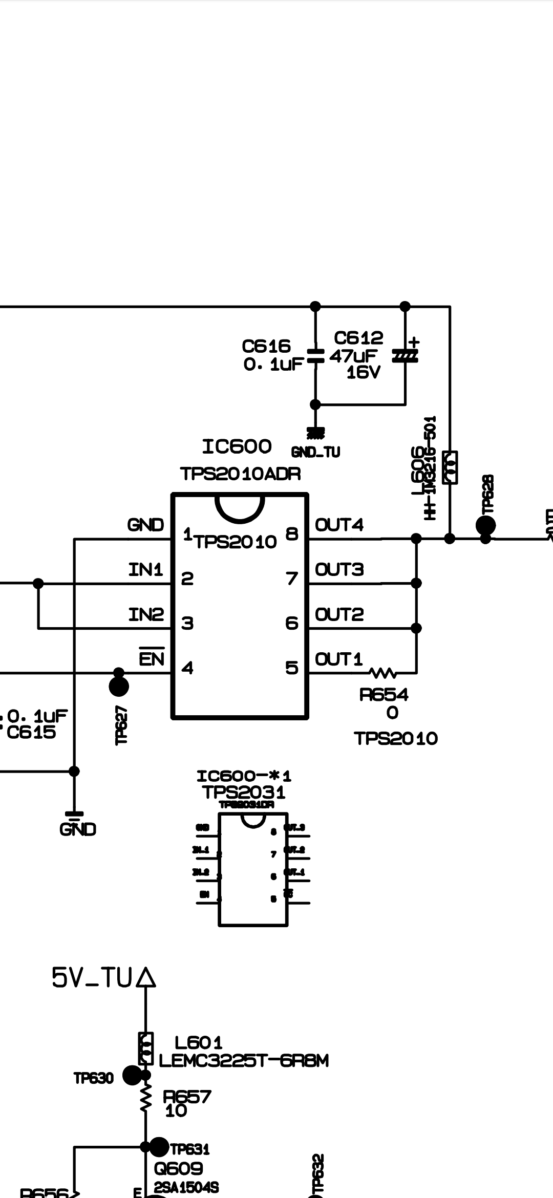

        Solved, thank you Click image for larger version
