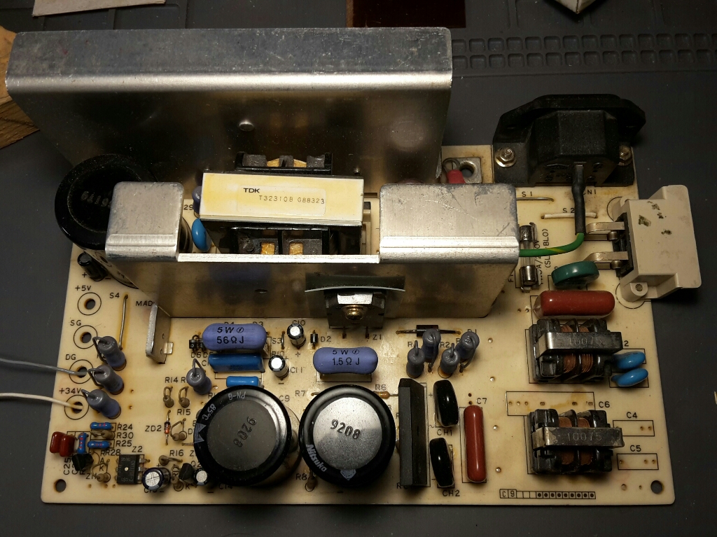

    I got old 34v psu (made in Japan) who was find in trash smashed apart. After I fix traces, and do test with unloaded output, I find that it has a problem and it is not secure to use.
    The output is galvanic isolated, and katode voltage of regulator is strange behaveour. If the unit is power on/off with enough big delay its seems that everything is good, but if it power on too quickly, before he discharge himself, it pass big current from primary. The problem is rigid and repetatible.

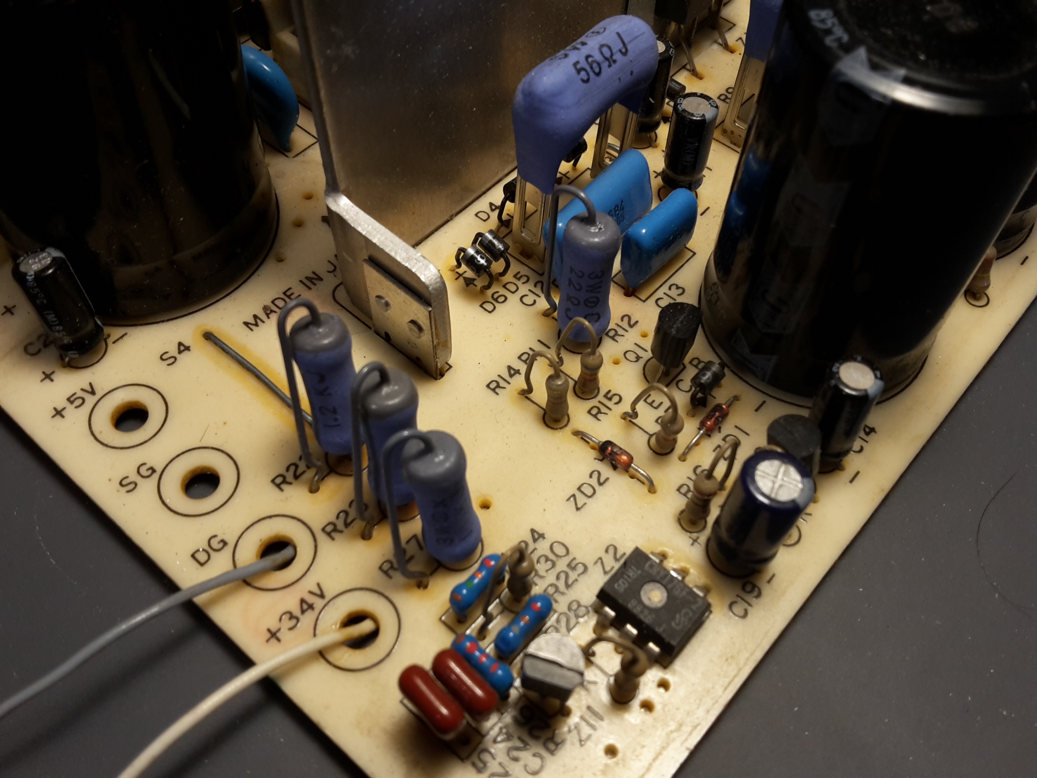

    I think that is some problem on output side so I traces circuit. On primary DC it have big STR16006 on heatsink, all component seems ok, only slightly discoloration below power resistor.

      I see date codes for 1992. Your electrolytic caps could be due for replacement, especially the three big ones. But check the small ones too, they are easiest to remove, test and replace. There may be a 'soft-start' feature on the regulator, and the electrolytic caps nearby affect this. If they have lost capacity, the soft-start may be too fast, overloading the rest of the supply.
        The 5v rail is isolated and regulated via own vreg. No feedback. I now solder a 1k resistor at this rail, but in first video there was noting connected. The 34v rail has onboard 600R resistor.
        Electrolitic has old but not bad, smaler electrolite I was replaced, but the big one I do not have. I test it with esr meter and it is pass. I doubt that this electrolite can do presented behaveour?

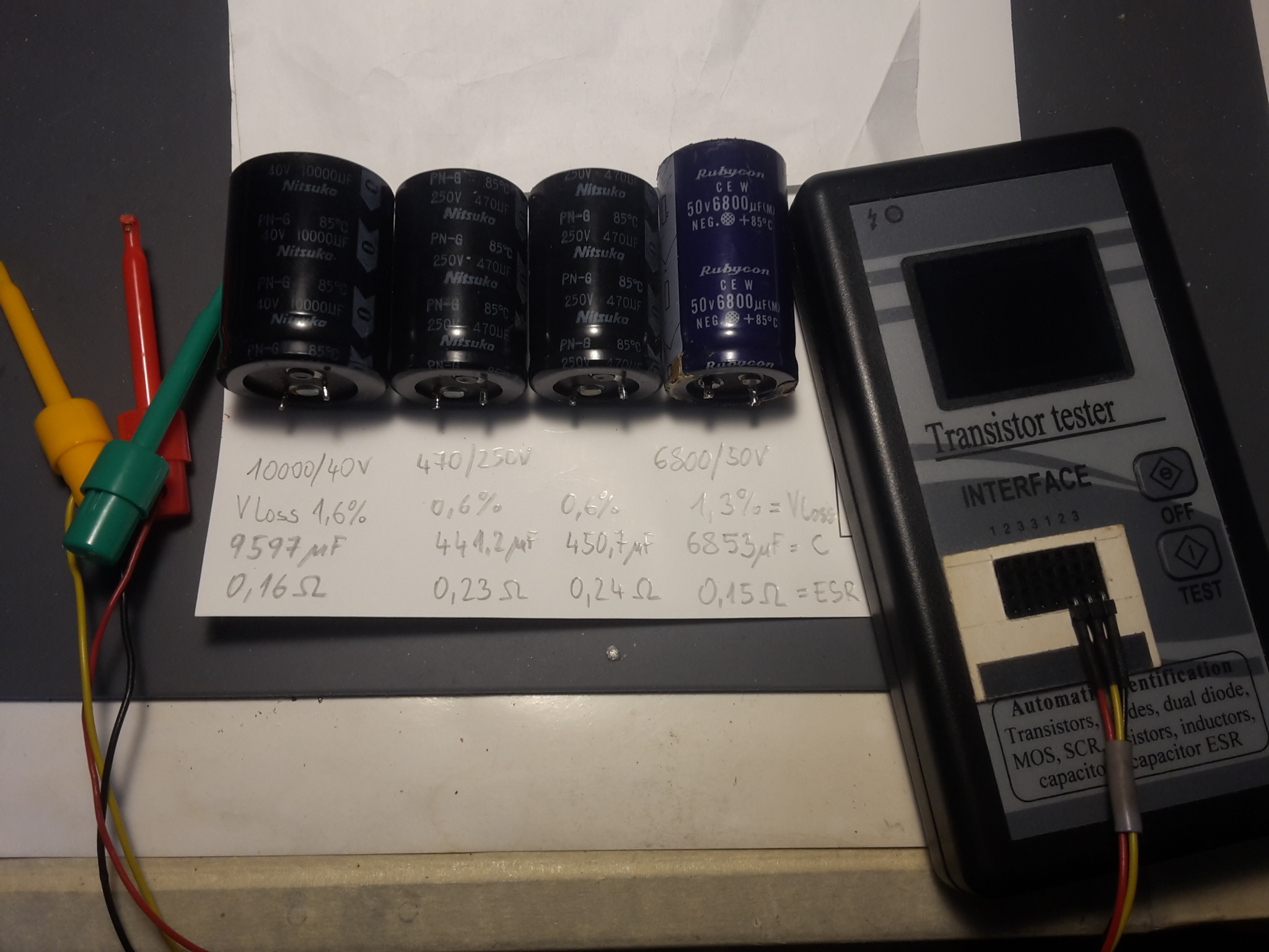

            I was desoldering all three big electrolitic caps, and test it with chinese transistor tester. The smaler two caps in the middle of picture seems to be in relatively good readings, but the biggest one 10000/40v got esr of 0.16R. All three caps are japanise Nitsuka brand. I found a Rubycon 6800/50v, but he has similar esr reading of 0.15R. So I suspect that this tester can not do some measurements on esr with resolution about 0.01R or less, so my guess is that all caps are preety ok and do not doing a problem. Or all caps that I have is similary bad. I will put it back and add Rubycon parallel with original.
            In the middletime, can anyone confirm that transistor tester can realy measure 0.01R of esr?
            EDIT:
            I shorted clips (with and without wire), and got same reading of 0.16R, so I must substract it from measurement. In that way caps are fully ok.

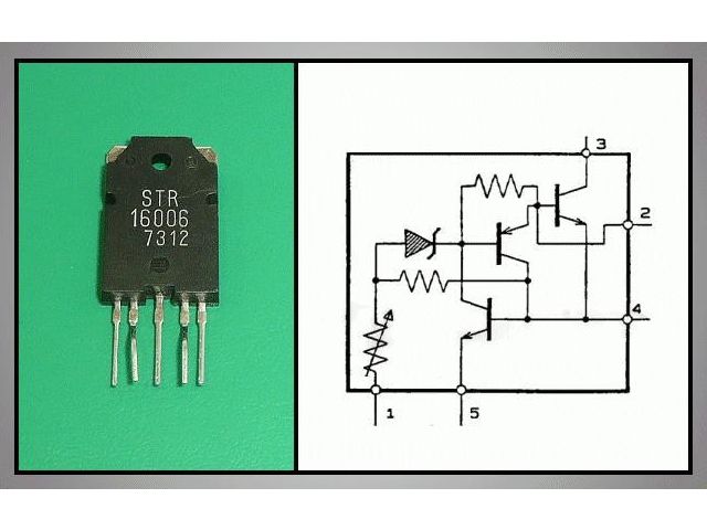

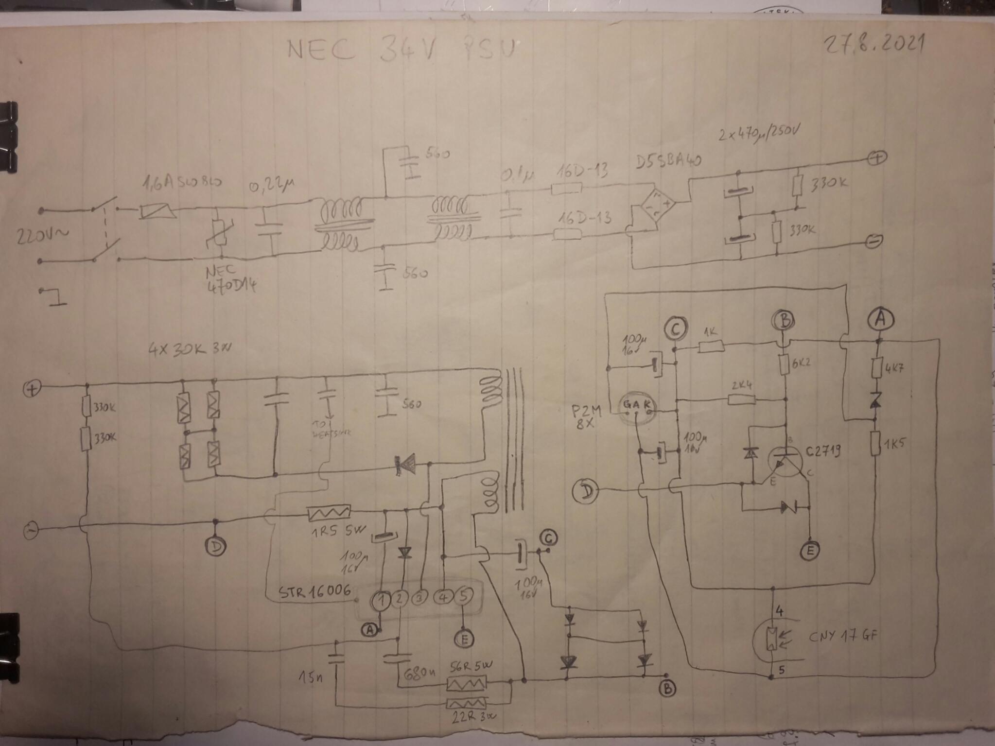

              Then I do schematics of the primary side, and I think to know where the problem might to be. All 4 little electrolitic cap is 100uF, and there are missing on first place in trash. I took replacement guessing that this should be enough, but it seems that are too big, or wrong value. Searching the web hopeing to find some example of str16006 psu circuit, but I cant find.
              Assume that this tought is correct, what cap will be suspect and with what value replaced?
              I put complete schematics in attach.
                Out of the four 100uF caps, I think the one connected between G and K of the P2M8X thingy is the most likely to be critical to get correct operation, so if you're going to tinker with it, try 47uF then 22uF, then try larger 220uF and see if any changes are detectable.

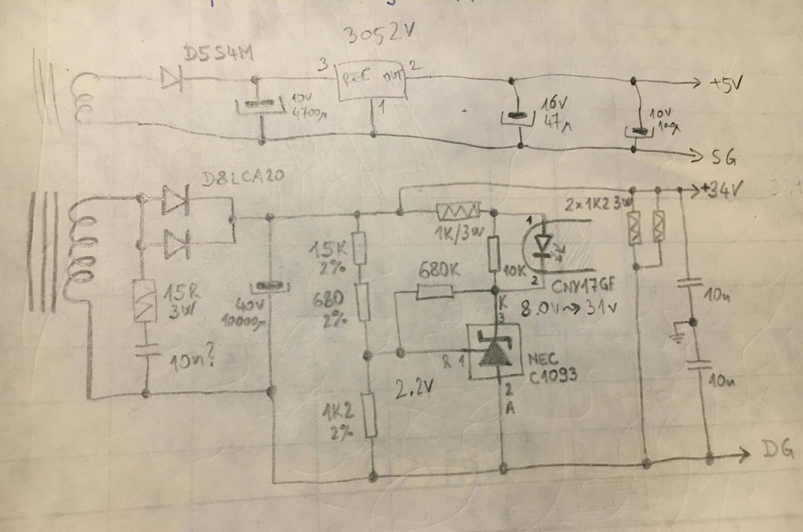

                      Now situation on shematic
                      C10 - on pin #1 str16006 chip is 4u7
                      C11 - on pin #4 chip is back 100uF (max to fit silk screen)
                      C14 - G-K is 4u7
                      C19 - A-K is 47uF (I put it bigger because silk screen)
                      The setup is working with same problem. How to troubleshoot the cause of problem? I dont know, but guess it something connected with feedback throw optocoupler, the secondary side? The psu is working just on that demand.
                      The A-K (sensing?) voltage is 1.14v if it is in ok state, and 3.3v if it latch to fail.
