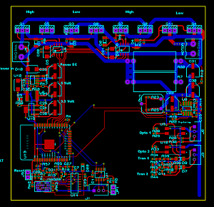

      drawing this at present which makes a change from the life support equipment I normally design. its a nmea controlled bow thruster for a little boat
      So yes I am ok with electronics and pcb design !
