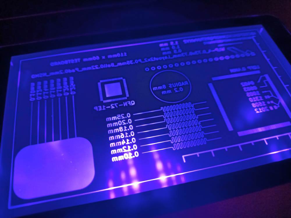

PCB fabrication on 3D resin printer.
  • PCB fabrication on 3D resin printer.

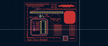

    step 1. Design PCB on Kicad or similiar
    step 2. export DXF or similiar
    step 3. convert to STL
    step 4. import to slicer software for resin printer and tweak print exposure times.

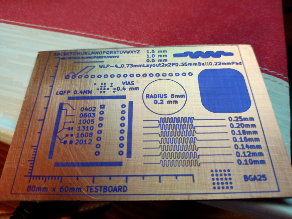

    step 5. expose sensitised PCB on printer
    step 6. develop
    step 7. etch.

    its able to print 0.1 mm traces ....
    Just wondering if anyone else has tried this :-)

      It's been a long time since I etched a board at home, printing 0.1mm traces is one thing, successfully etching them, well!
      Cheers Mick
        you don?t need photo sensitive pcb
        just add some drops of uv resin into the tank between copper side of pcb and fep foil
        then exposure a minute or so (first layer time for resin)
        then remove pcb now you should habe the track lines covered with cured resin
        wash the rest off with alcohol, reday for etching

                  Yikes, that's high shipping. Do you have a pic of an etched board? That's where I always had trouble.
