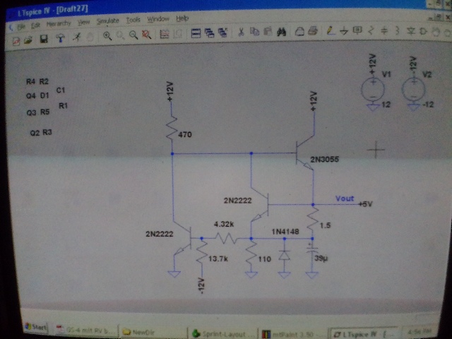

                        According to a bit of reading on the subject of 'average' linear IC regulators, the error amplifier contained inside is something like a 'UA741' opamp, hence the noise generation. The first step when making a discrete regulator is to use a decent low-noise opamp as the error amp. Then decouple/filter important internal points in the circuit, like the reference generator. Then tricks like powering the opamp and / or the reference from the output of the regulator, to give them a clean rail.

                            3 transistor voltage regulator +5V from Tektronix scheme.
                              Zeners below 7V should work well, and the best noise-wise is about 6V. Below that they have even less noise, but their inner resistance is getting high, and temperature dependence is more pronounced.
                              Band gap references are fine for temperature stability, but their noise is bad. Most of the regulators come with a band gap reference.
                              Red/yellow/green LEDs are fine, but also drift with temperature.
                              Diodes are fine, including Vbe ones, but same as LEDs need a few mA to run silent.
                              Best choice is to build your own regulator and use a 6.2V zener or a string of LEDs as reference.
