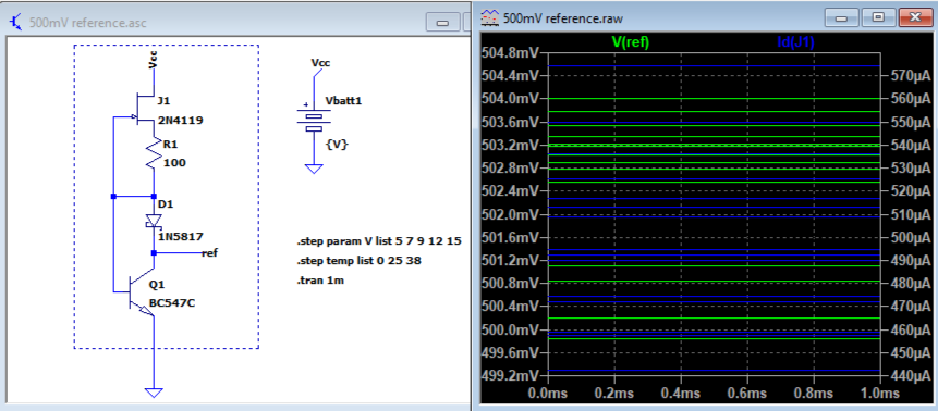

Cheap 500mV 1% temp compensated voltage reference circuit
  • Cheap 500mV 1% temp compensated voltage reference circuit
    This reference varies 1% from 0 to 38 degrees temperature and 5V to 15V supply.
    For a fixed power supply it can be simplified by removing the JFET and selecting a higher value of R1 (3k - 10k)
    Click image for larger version  Name:	Schermopname (292).png Views:	0 Size:	68.6 KB ID:	415563
