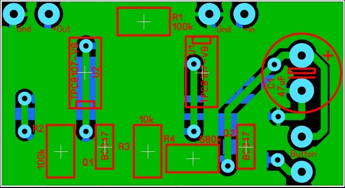

A small "treat" for hobbyists
    No objections?
    Case closed!
ID:	415919Click image for larger version

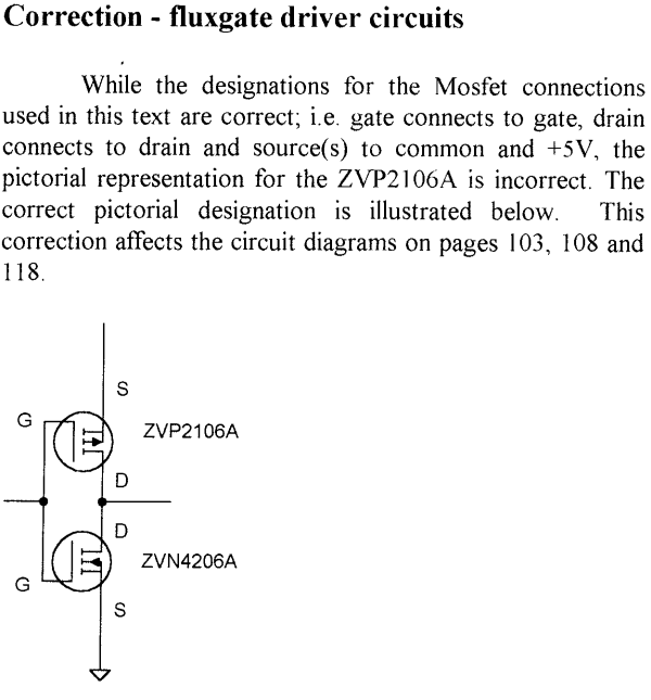

      Click image for larger version  Name:	image.png Views:	0 Size:	94.2 KB ID:	416145​
      Seems I am not the only one to mix up the schematic symbols!
      BTW Carl THANKS for posting that PDF.
      Topic is "closed" so I can't thank You there for it.
