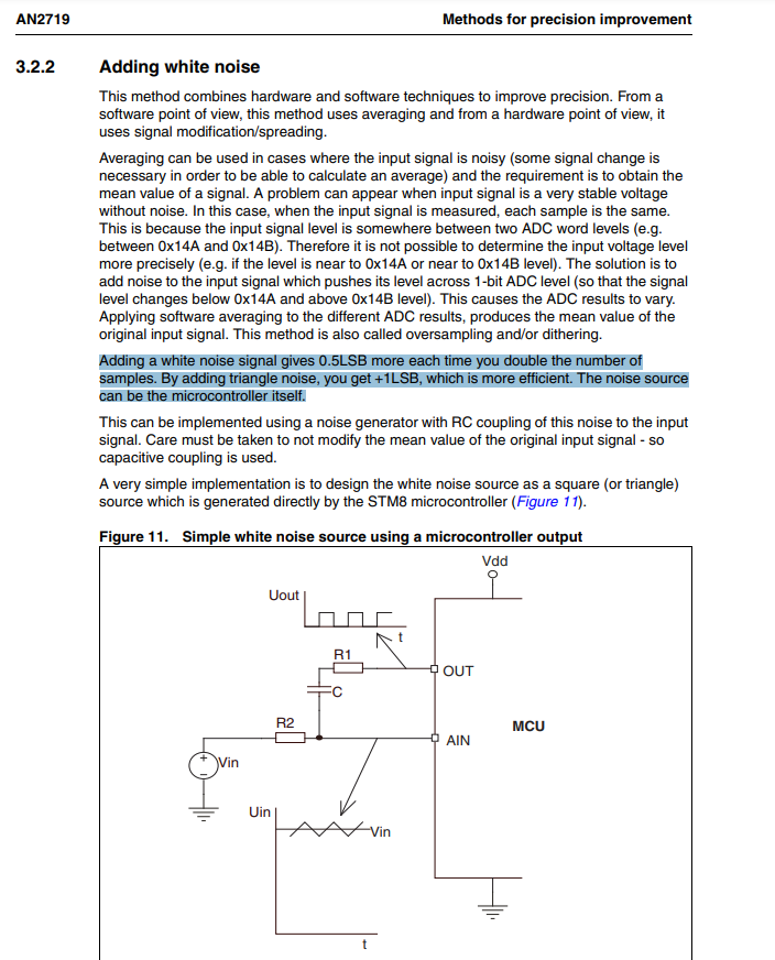

    But it can get even better, who knew that adding triangle noise gives you +1 bit improvement each time you double the number of samples?
    From this application note by ST https://www.st.com/resource/en/appli...lectronics.pdf
    Click image for larger version  Name:	Schermopname (340).png Views:	0 Size:	175.8 KB ID:	418757

      Most of us know about the white noise dither, so this post is about better options that are less known.
