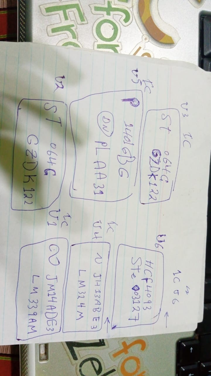

I need help finding some ICs for a clone Bounty hunter MD

                    Yes in EGYPT...the thing is i don't know too what's available here
                      U3, U4 : TL064 opamp x 4
                      U5: CD4016B CMOS analogue switch x 4
                      U4: LM324 opamp x 4
                      U6: CD4093 CMOS logic 2-input NAND gate x 4
                      U1: LM339A comparator x 4
                        U4: LM324 opamp x 4
                        Thanks a lot for the effort just excuse my little electro knowledge,you mean these are some alternatives?
                        I see U3 and U4 go with TL064 also U4 goes with LM324?
                        So does it also go with the U3?
                        But why no mentioning for U1
                        the term opamp x4 what it mean?

                          The correct way of saying it is "Quad" meaning inside the ic are 4 single amps.
                          LM339A= Precision quad differential comparator, and LM324 = Quad 30-V 1.2-MHz operational amplifier.​
                          TL064= Quad, 30-V, 1-MHz, In to V+, JFET-input operational amplifier
                          Its impossible to know all the different IC's even if you work with them every day,
                          So your best bet is to Google the ic code to see what it is.
                          If you add your internet code to a google search then you should be able to see whats available in Egypt.
                          ie lm324 site:eg shows amazon.eg and a place called Jumia Egypt.
