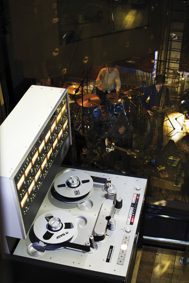

        The ( analogue ) tape machines they used in recording studios were a bit better than your home reel to reel though.
        Like the Studer A800 24 track analogue tape recorder circa 1978.

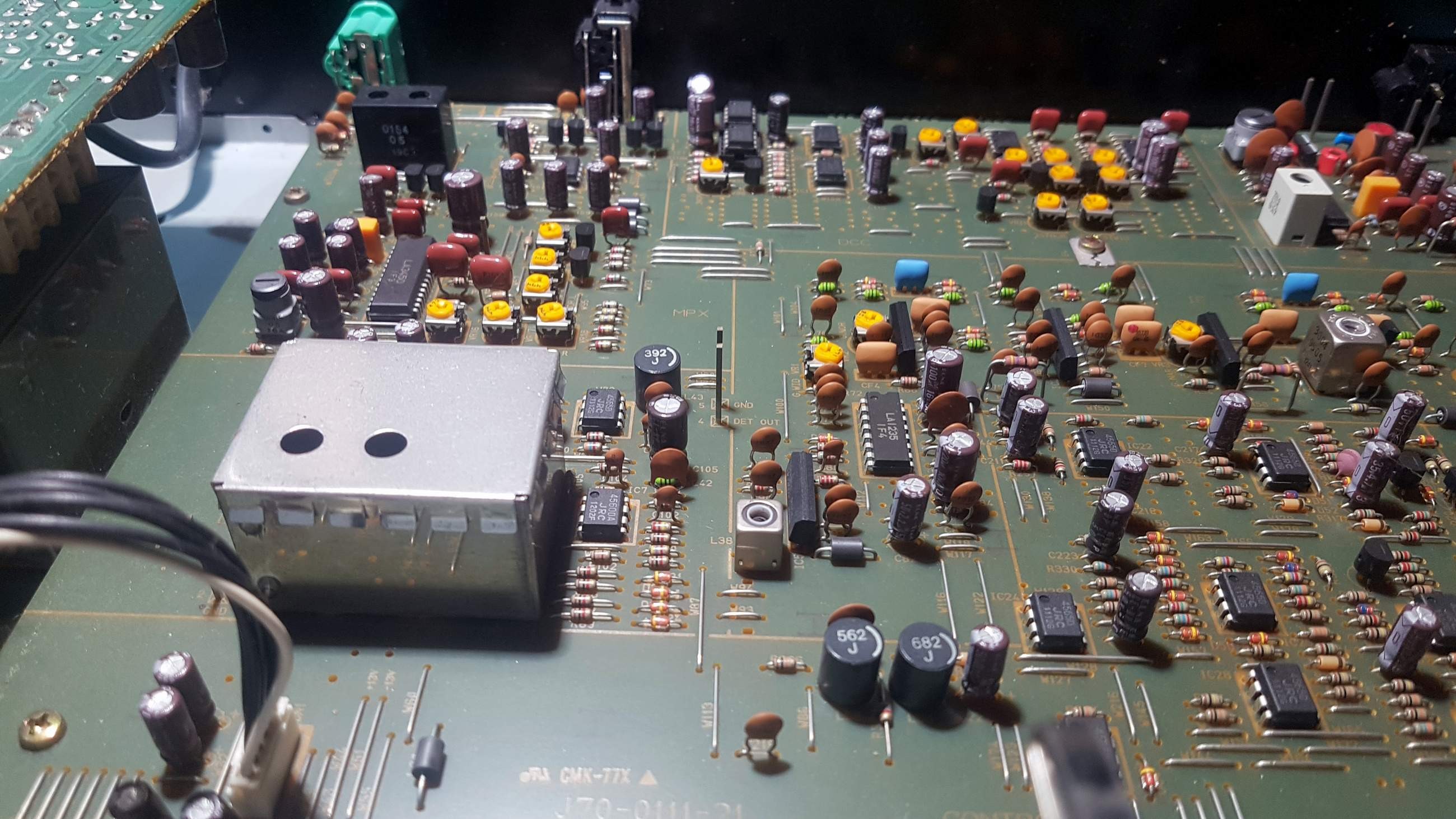

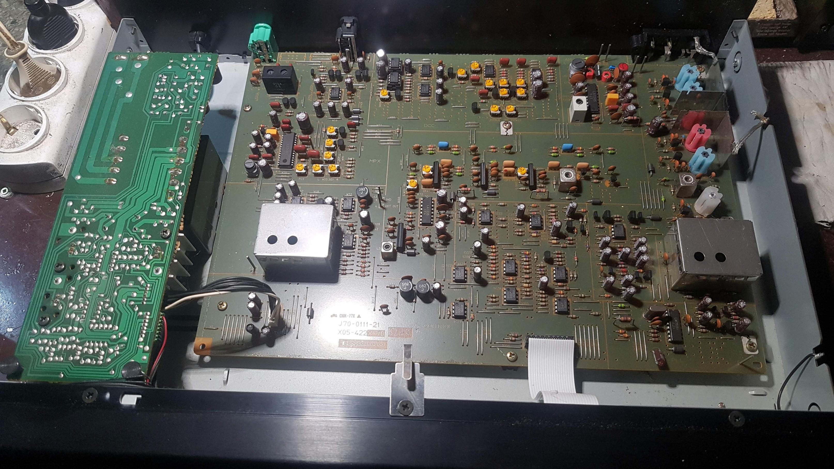

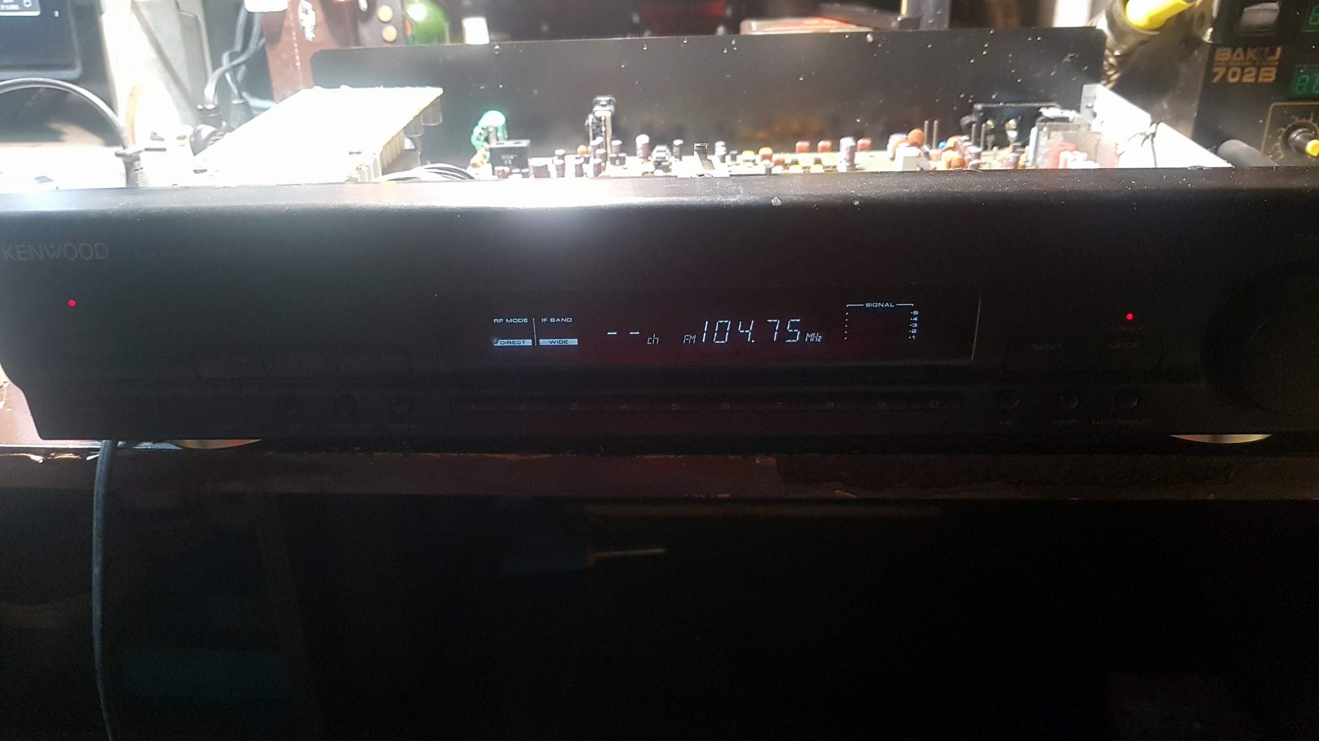

            The other day I accidentally received a Kenwood radio receiver, model KT-6040, as a gift.
            Older production.
            What can I say? Perfection!
            I have a lot of radios in the house.
            But this model catches the most stations, has the warmest sound, I've never had anything better in my life.

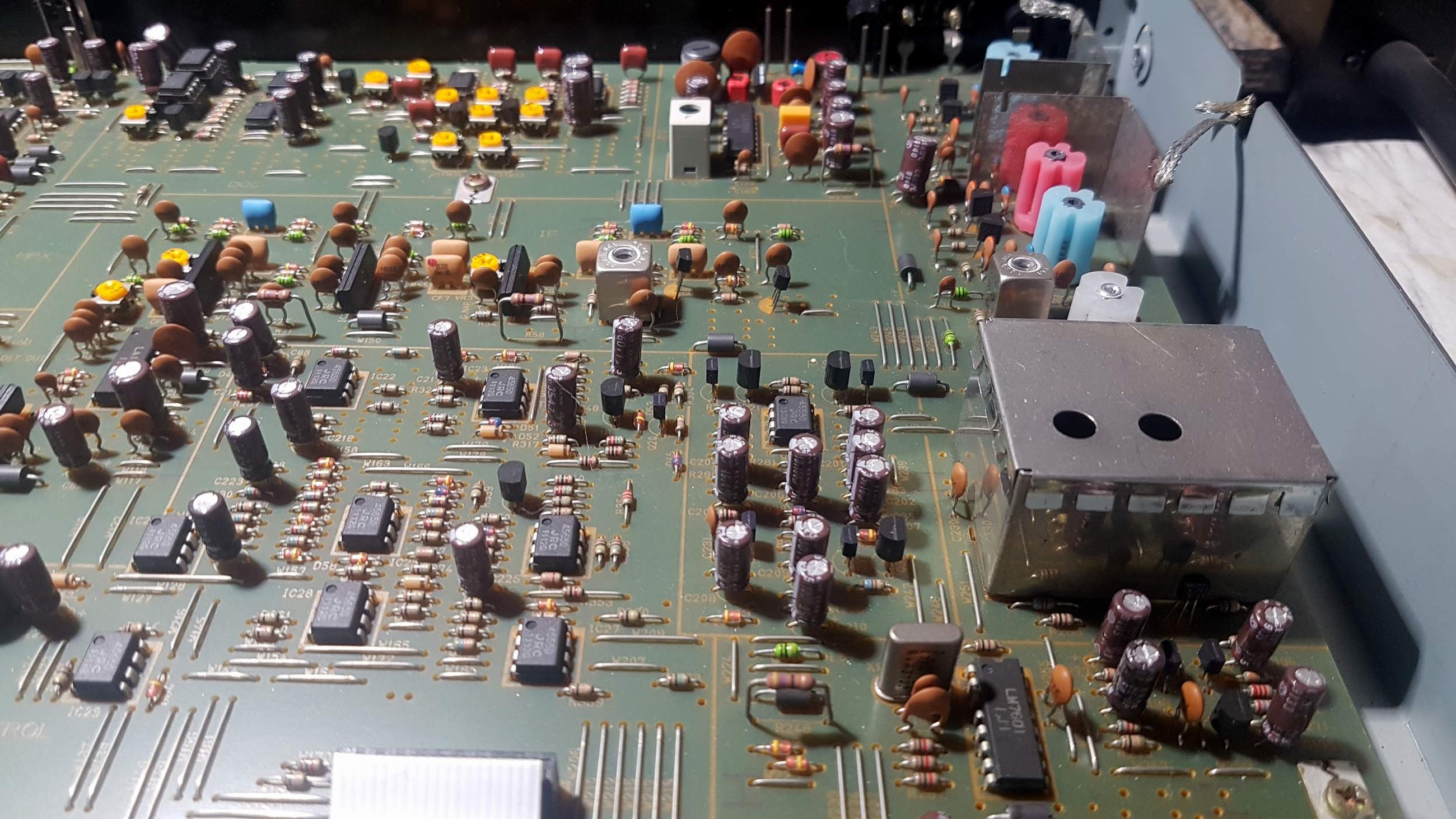

              Before I even thought to plug it in, the first thing I thought was, "Here at last is a great harvest of good quality opamps to use in my metal detectors..."
              And indeed inside I came across a large number of opamps!
              Alas!
              Not one to catch my attention!
              Not one that I would put in a detector!
              They are all old and outdated.
              That's why I decided not to tear it apart but to try it to see if it works, if it's correct.
              My delight is endless when I see how well it works!
              Where does all that quality come from?

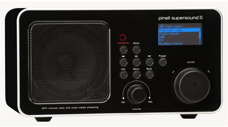

                  I have a Pinell SuperSound internet radio, made in Norway, with which I can listen to literally every radio station on the planet.
                  I choose a continent, a country, a city and it gets a list of stations.

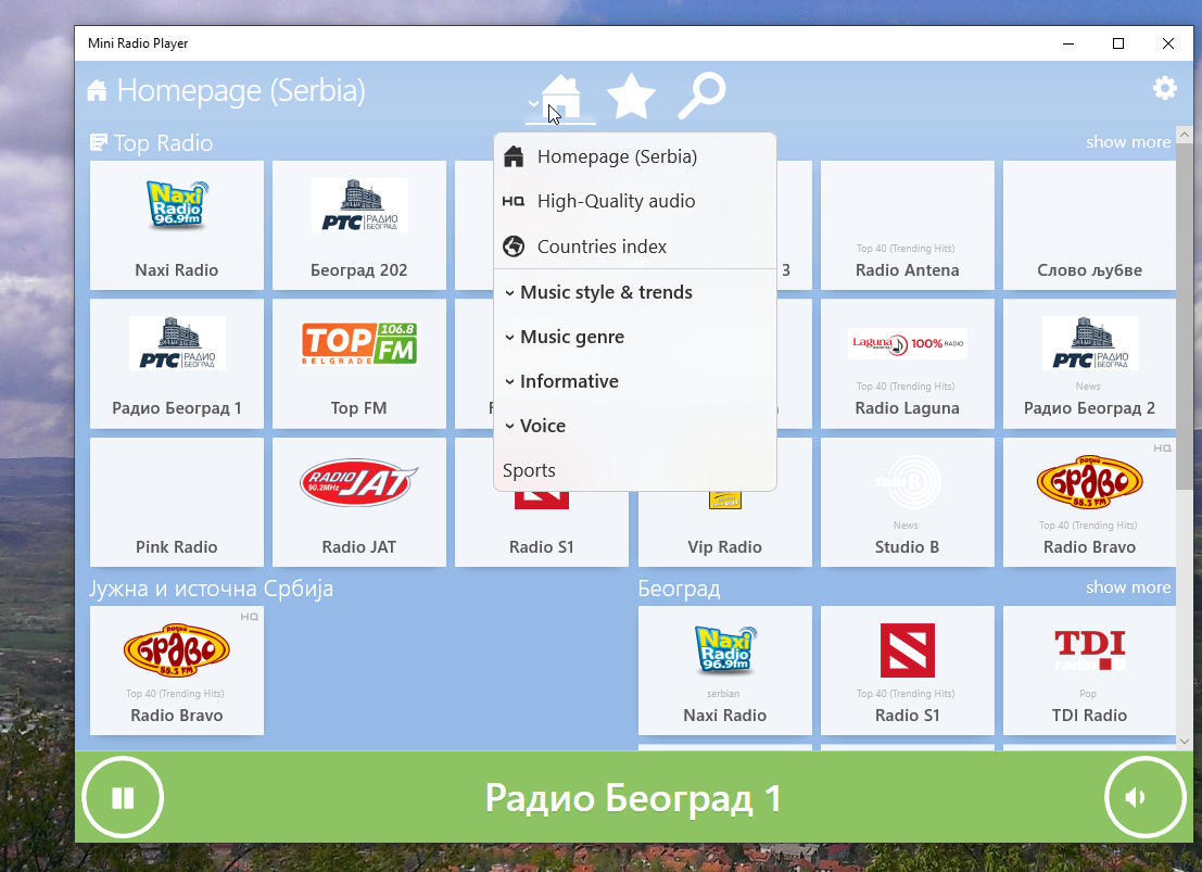

                  On my Windows 10/11 desktop I have a "Mini Radio Player" app that works perfectly.

                  I have this radio, among many others I have, I favor it because it works unexpectedly well:
                    Or on Win10/11 I use this one:

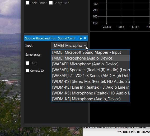

                      First download and set up this software (sometimes it downloads dotnet.. the installation that is needed).
                      Download the best SDR software and plugins for Airspy, RTL-SDR dongle and many other radios!
                      Then connect a few meters of quality coaxial cable to the MIC input of your desktop/laptop computer (shorter or longr cable if necessary) and tie a coil with as many windings as possible to the end of the cable.
                      It is desirable that the coil is wound over a ferrite rod from an antenna.
                      And this is where my genius comes in again... and my bad side is that I can't keep secrets, sometimes I act like a torn sack with lots of holes trying to transfer water!
                      However, "my Highness" has no problem with that... you should always give a little bit to the poor people!
                      Instead of bothering with idiotic manual winding of coils... READ what's coming next, bellow:
                      Do you know what an electrovalve for water for washing machines is? Every washing machine has two of them at least.
                      They are very cheap. You need to bend and remove the metal parts and holders with strong pliers and you will be left with a very nice and properly wound coil with 2 leads.
                      The icing on the cake is the hole through that coil, which has the ideal width for threading a ferrite rod from some discarded antenna.
                      And that's how you got the perfect ULF antenna in no time!
                      Stop the standing ovations... my ego is huge, I don't need any extra boosts!
                      So you connect such an "antenna" to the other end of the coaxial cable...
                      In the SDR# software, select the appropriate input:
                      Click image for larger version  Name:	image.png Views:	0 Size:	300.8 KB ID:	438368​

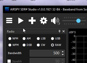

                      And "voila"... you have free ULF reception with a spectrum analyzer.
                      With which you can listen to signals below 22kHz.
                      "Raw" or "CW"... I leave the rest to your imagination...
                      ​Click image for larger version  Name:	image.png Views:	0 Size:	77.6 KB ID:	438369​
