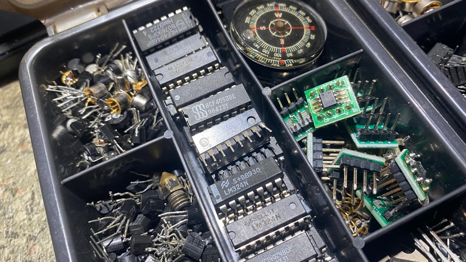

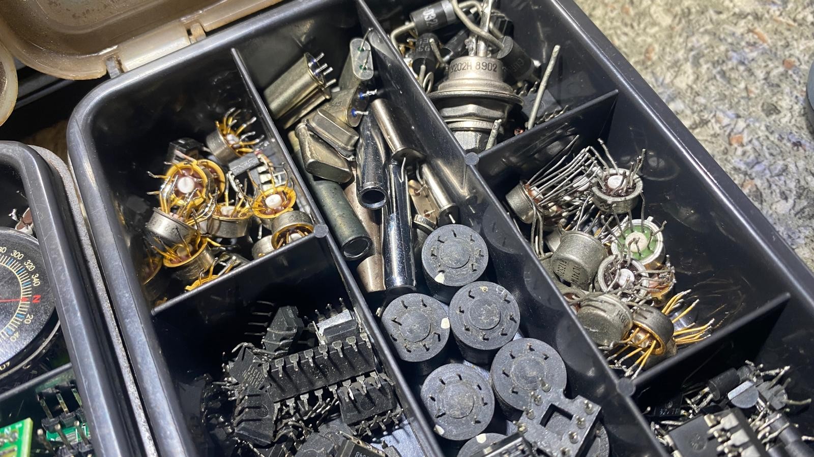

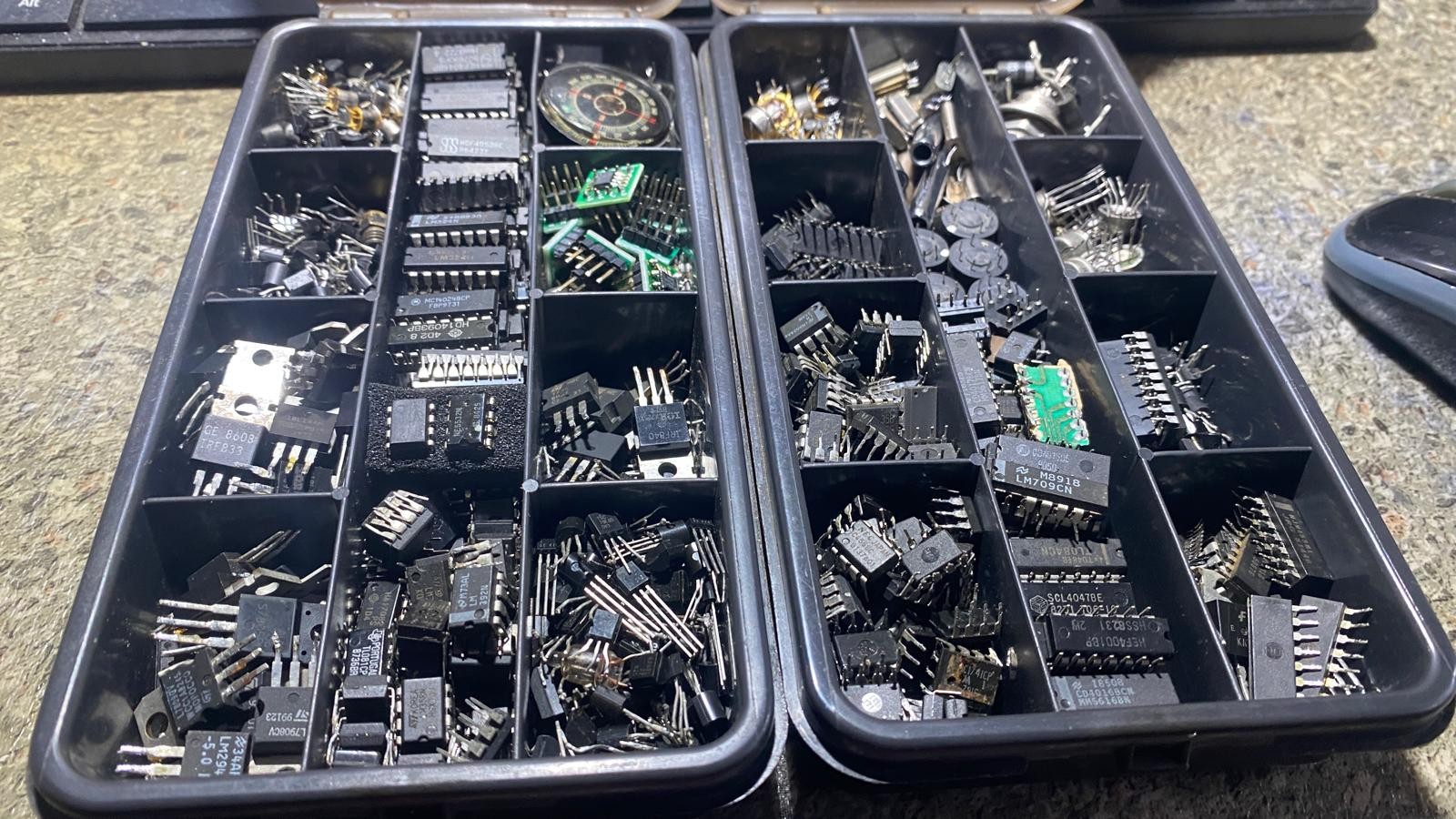

    One of my more important hobbies is going to junkyards and rummaging through piles.
    I've been practicing it for years.
    Great fun!
    Are you wondering why?
    Another thing; I never throw away used electronics, I store them in the attic.
    Things are pretty clear, the world is slowly going downhill.
    Chinese goods cannot be trusted and Western goods are rapidly declining in quality.
    These are pictures of 1/100 of the material I have and keep.
    Note the "military standard" opamps in metal housings.
    Most are LM308H and few 741. There are also some other very interesting ones.
    Most good components can be found on used and vintage medical equipment.
    As for NE5534 and NE5532; quality pieces can be found in discarded musical equipment.
    Audio mixers, preamps etc.
