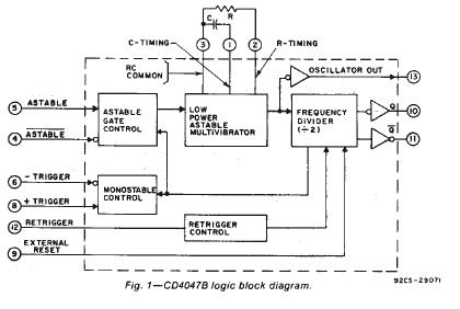

            Maybe dissapoint the old and versatile 555 because today is PIC's market, and well, they want to sell, include for very simple projects. Another cheap chip (good combination of words!) is the 4047B with similar functions of the 555, you need only 2 external components. Include frequency divider by 2:
              The 2x frequency would be handy for clocking a 7660 charge pump, which divides by 2.

                Hi Esteban,
                yes I've used too in small power inverter. It has also symm not overlapping pulses.
