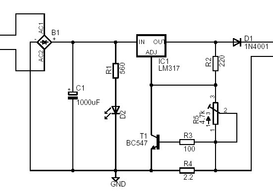

                    The Gel-type lead-acid I mean is 12v 1.2Ah for a weight of 400-450gr (cause of lead and other stuff).
                    You need the second circuit to charge it well... circuit works pretty good as is...I suggest , if you wanna stay safe with battery life, you change the 2.2 ohm resistor to 4.7 ohm one. That will limit maximum current at about 125mA.
                    You can leave battery always connected to this charger without damage cause of the diode ... just have use a 16-18VAC adaptor and to set the trimpot for 13.8V output without load.
                    With lead-acid 1.2Ah your TGS will run at least 24hours before you need to recharge.

                      I have found some 12V battery 1,4Ah and I think it's lead-acid type.Its hevy but I am sick of this NI-MH experiments.So what do you think can I conect this dirctly to TGS?Or I have to add some other components too?
                      In the shop they dont have chargers for this one!I ask them what they think and they told me to conect to ac/dc adapter directly?I am afraid to listen to them anymore ,so I ask you!?
                        Originally posted by tiktak View Post
                        Hi Max,
                        you can use, no problems apart weight.
                        For charger use the circuit of above, will be fine.

                          Hi
                          Hi Max,
                          What is B1 on this picture?
                            Hi Max,
                            That's a bridge rectifier, used to convert AC voltage to DC voltage.
                              Max please explain again:
                              I just bought this 12V 1,4Ah battery it's lead acid type!
                              I have this stupid ac/dc adapter that have scale for voltages.On back side its labeled that its giving 400 mA MAX.Is this mean that when the scale is set for max voltage its give 400 mA then.?
                              Can I try with this AC/DC adapter because I cant understand this scheme that you give me/I am Nob you now/.Again with some resistor?
                              The AC/DC adapter should be put in 12v range right?Or
                              Sorry again for the stupid questions but I wanna finish this finaly!
                              p.s.If you give me some advices I will try to build this circuit but what are AC1;AC2;where should be batteries be conected?
