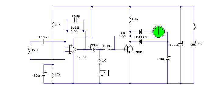

                          Here is an EM Meter schematic that may work with some tweaking, the meter could be replaced & maybe connected to a pc or oscilliscope. Some input on this would be good!
                          A metel detector reciever circuit is also an EM Detector is it not?

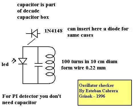

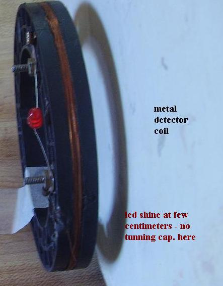

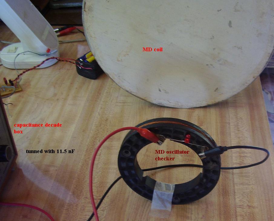

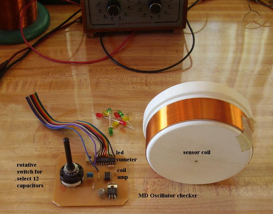

                              My simple and old method. With tunned cap., the detector "scream" at min sensibility causes the resonance of the checker coil. Also is waiting my project with bargraph leds (2 years ago) . I forgot this... I'm in other things, only need to insert correct capacitors in conjunction with rotative switch and drawn the frequencies in panel... Don't know if is useful for to patent this...
