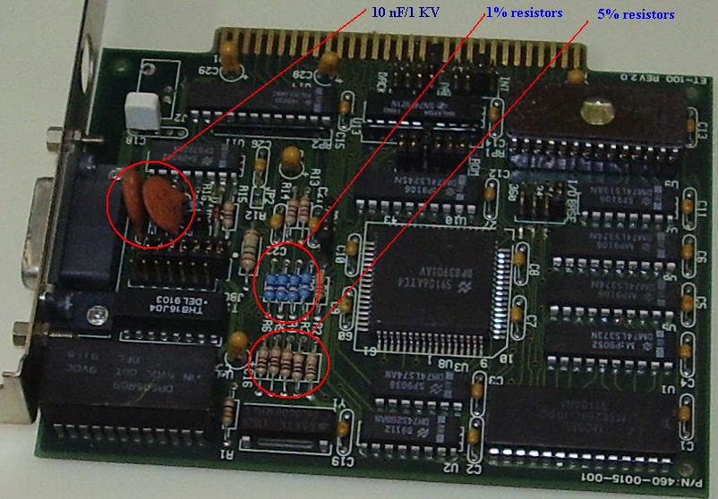

    1% resistors, common resistors, 1 KV capacitors, tantalum...

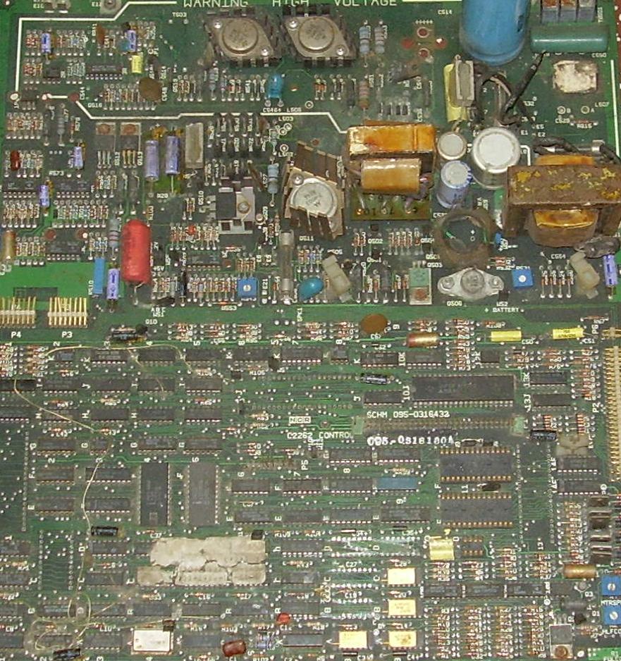

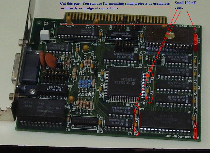

      Here a big PCB wich gives me many components...

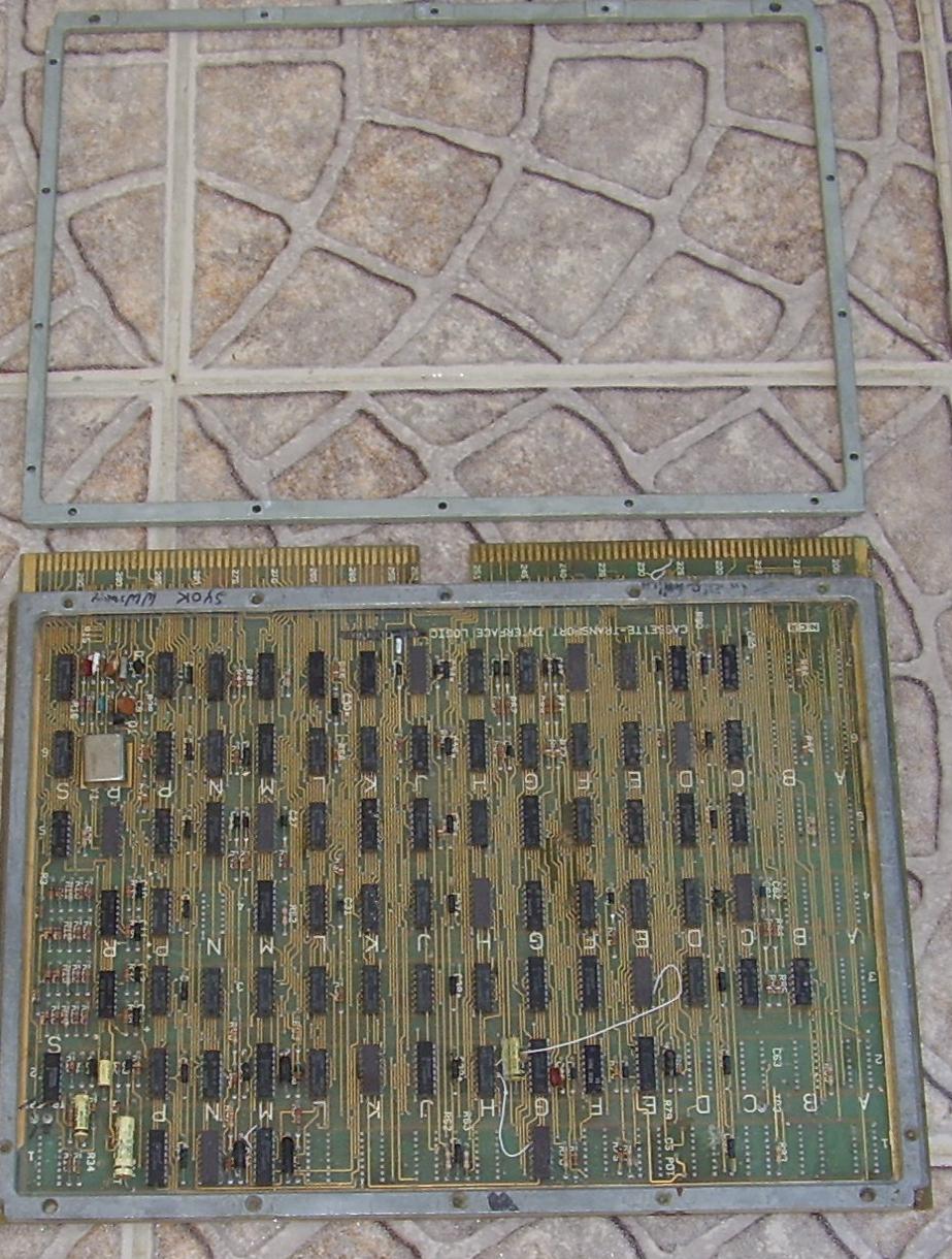

        Here an aluminium square form can be used for absorptive pistol or two boxes. One was disambled... with drill.

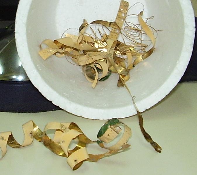

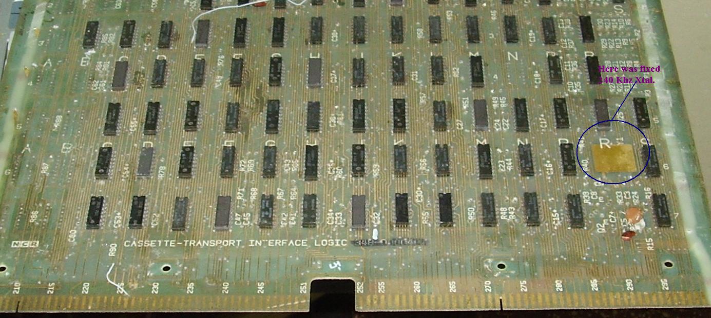

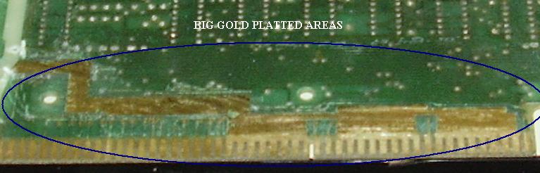

          Gold platted from old NCR PCB, 3 pics. See the big areas.
          All the lines are platted in gold in this PCB. Keep for
          use in gold classifier for pistol. See at right of big
          photo the place of the xtal.
          You hot the lines and "dis-paste" slowly.

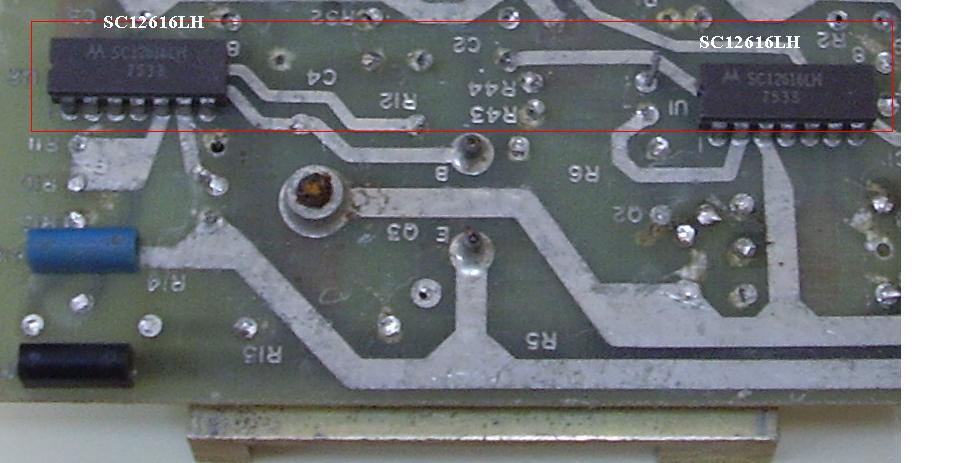

            SC12616LH
            No info found of this Motorola IC! Before go garbage these "peeling" PCB, wish to know what are some components. This is a case.

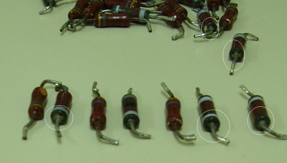

              Perforated resistors! Strange for me! But the holes don't trespassing the resistors. Also strange values as 4.720 K, 91.100 K, etc., and white final band.

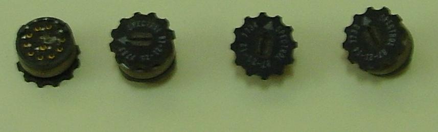

                Spectrol rotative switches for PCB. 2 positions, 4 positions, 2 poles-5 positions.

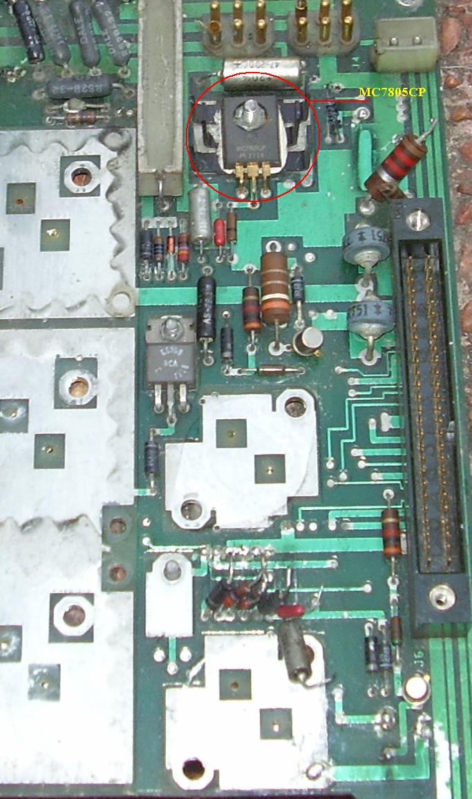

                  MC7805CP. Motorola voltage reg. Year 1977. Looks very good! Now I have 2 of the same.

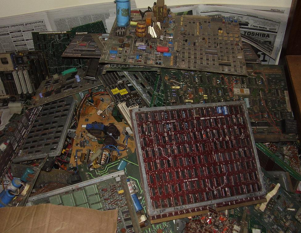

                      I have many and need to dissamble all the PCBs because problem with space...
                      Also a friend gove me a box of ceramic capacitors, thousands... But I noticed that Mial brand is very stable and accuracy, all values I have since 4 pF to 220 nF, some of these 95 pF 3 KV, etc.
                        Tons of PCBs waiting dissambling.
                          Other uses you can found:
                          Uhm, yes, kinda of "barras"...
                          Maybe you saw somewhere else, similar approach... ???

                              Yes, I remember. But also you can mount in it oscillator, etc, small projects for to test.
