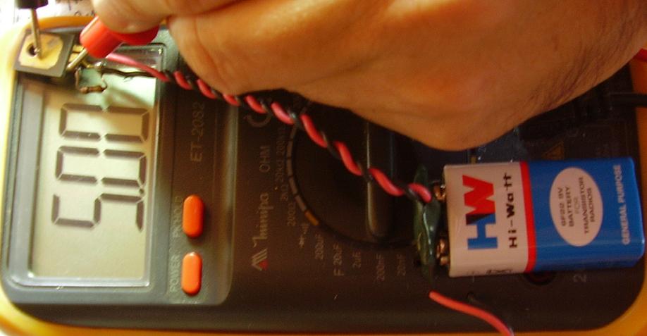

    Well, I'm dissambling tons of old PCB from different kind of equipments. Yesterday, I show in thread "Recycling components" a Motorola MC7805CP volt. reg. dated 1977. I bought many of different brands and is very rare obtain the 5 V, ever shows 4.80, 4.90 and also tends to fluctuates on tester. This old IC is platted on gold, pins and dissipator body (back part). See the accuracy, also don't fluctuates on tester! Seems we buy garbage in comparisson with this...

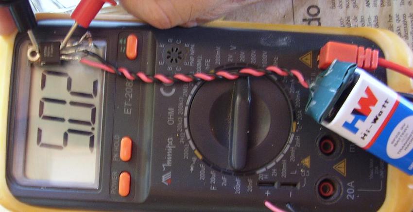

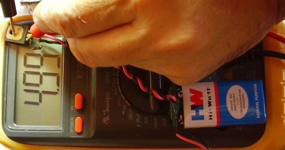

              Starts with 5.00 V and when resistor is hotting stay in 4.99. Was in this voltage 1 minute. The battery I used is deffinitively bad and cheap, and rapidly discharge to 7.90 volts. Even with this voltage stay in 4.99 during the 1 minute test. Here now is 34.3 ºC. See the 2 pics.

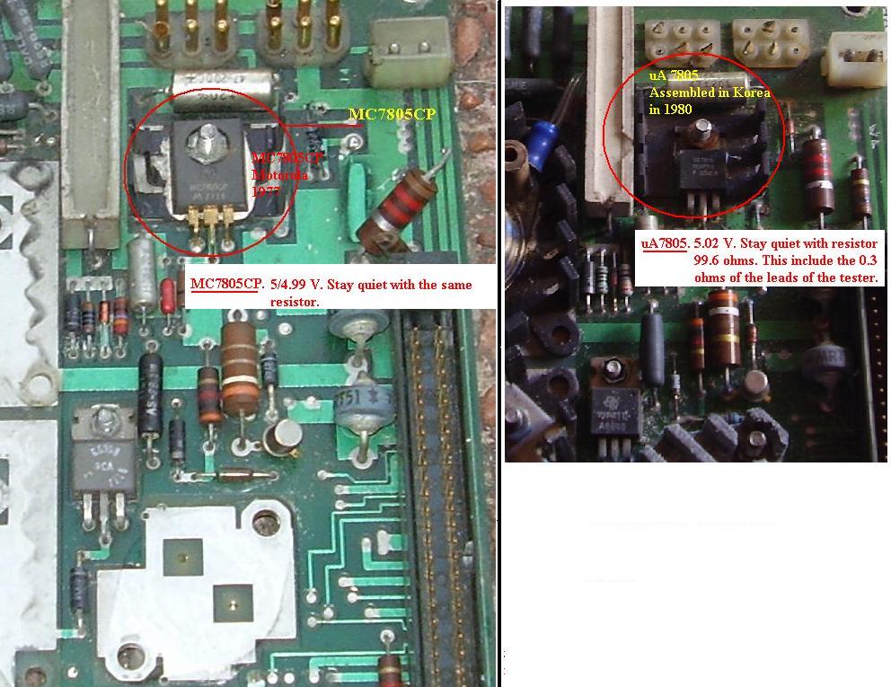

                I agree. Some chips of today maybe are based on more modern assembling technic, but not very good material. For me, this MC7805 CP regulator by Motorola is exceptional, maybe was ordered under stricts procedures, body and pins platted on gold. Maybe this is not very important, but I see here more dedication... .
                  Also, the IC maybe works for years and voltage is good today! Was "cooking" in the PCB for some years.
                    Here photo of 2 equal equipments. One uses the Motorola MC7805CP and the other is marked as uA 7805, manufactured
                    on 8014, 14 week of 1980. This was made in Korea (assembled). I know that was assembled in Korea by USA
                    and matrix machinery. Maybe this not mean "Made in Korea".
                      Assembled in Korea... uA7805 of 1980.

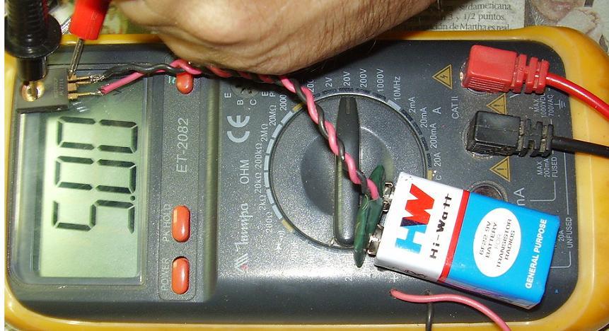

                      Stay quiet in 5.02 V with load 99.6 ohms without variations. Tested for 1 minute at 34 ºC.
