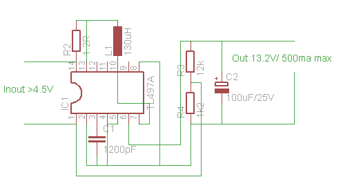

          I found at a local electronic shop the TL497A. About the same, more current but need at least 4.5v input. No problem.... i connected it with 4 rechargeable AA batteries and now i have the 16.5 v that i need plus a 9v stabilized.

            Hi! Geo
            Can you post the schematic here???
            Best Regards
            Dirceu
              Originally posted by DIRCEU View Post
              Hi! Geo
              Best Regards
              Dirceu
              Hi.
              I will draw it and i"ll post here
                Dirceu here is the schematic.
                To change the out voltage you must replace the R3.
                Vout= 1.2+R4(Kohm). So for 9v you need a 7.8K resistor.
                  Hi! Geo
                  Very good and useful.
                  Many Thanks, Geo.
                  Dirceu.
                    Vout= 1.2+R4(Kohm).
                    Geo, thanks.
                    Are you sure in given formula?
                    On schematic you have: 13,2V=R4 (1.2k)+R3(12k)
                    Then formula have to be: Vout(V)=1.2(V)+R3(kOhm)
                      Geo, thanks.
                      Hi WM6
                      I made mistake between R3 and R4.
                      Yes you wrote the right formula.

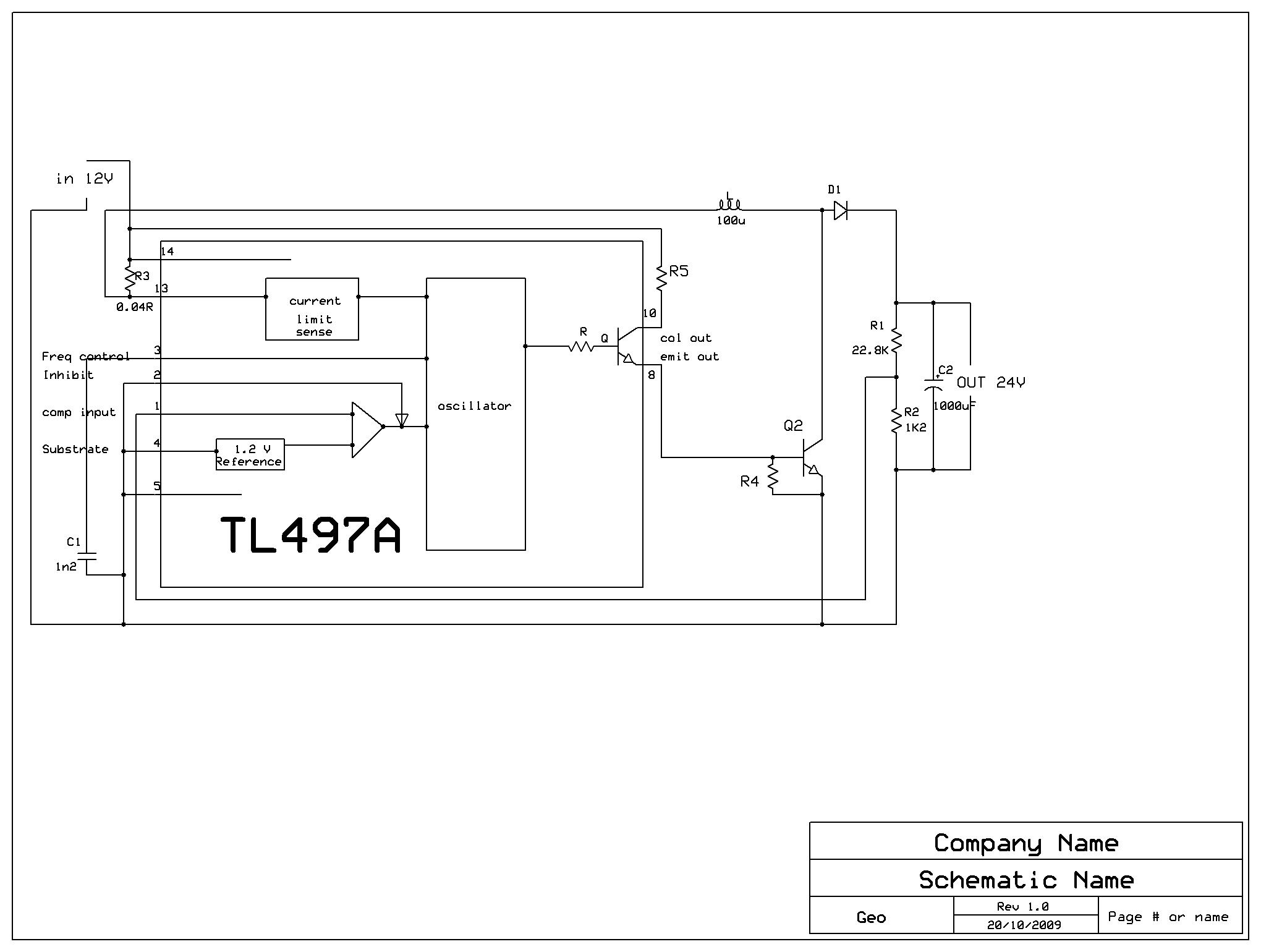

                        Hi.
                        I attach a schematic of a converter from 12V to 24V.
                        I took the schematic from Texas Instruments datasheet and i made the calculations except Q2, R4 and R5.
                        Who can help me, so to calculate the R4,R5 and Q2??
