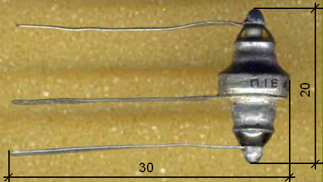

    The LN transistor
    The transistor Q1 was ancient germanium PNP type П1Д made in "Svetlana Leningrad" factory in St. Petersburg, Russia. Despite large dimensions shown below, maximal power is 50mW only. Transistor П1Д has about 18 dB noise, but because of the narrow band, the stage generates noises smaller than modern IC stages used in metal detectors. To experiment the stage with an low noise silicon transistor ZTX214C, I decided to calculate how much should be the collector current in operating point for minimum noise. I found a formula in the textbook "Applications of analog integrated circuits" by Sidney Soclof. According to formula, the low resistance of conventional RX coils, requires preamp transistor to work with collector current much stronger than used for operating point of input stages in IC opamps.

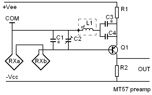

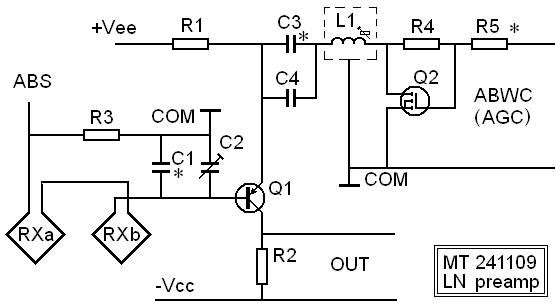

      My Components
      My Components for test of ancient MT57 preamp:
      Vee=5V, Vcc= - 5V. Total inductance of RX coils is calculated for resonance with total capacitance at frequency 6500Hz. Mutual inductace between RX coils is positive, but it is so smal that can be neglected by calculation.
      Total resistance of coils RXa + RXb = 90 + 90 = 180 ohm. Measured stray capacitance 210pF.
      L1 is made of adjustable potcore D=14mm, H=8,5mm, AL=400nH/turns^2. Resistance of L1<5 ohm.
      C1 + C2 = 140pF, C1 is selected for resonance at middle position of C2.
      C3 + C4 = 6800pF, C3 is selected for resonance at middle position of L1 ferrite core.
      R1 = 5K11F, R2 = 4K02F
      Q1 = ZTX214C, operating point : Ic=0,9mA, Ve = +0,6V, Vc = -1,6V.
      IMPORTANT NOTE: This analog narrow band preamp is not suitable for conventional block diagram of metal detectors since they use TX coil voltage as reference signal for synchronous demodulation. The analog narrow band stage has unstable phase characteristic, which causes unstable discrimination. To use this circuit diagram in discriminating MD, the reference voltage for synchronous demodulation should be derived from preamp output (as the synchronization in oscilloscopes and televisions is derived from received signal).

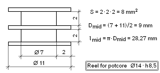

        To have a minimum coil resistance, must choose a thicker wire so as to fill the whole window of reel. As is shown in the drawing below, the window has an area S = 8sq. mm. Hence we can calculate the maximum external diameter of the wire with insulation:
        (6) d = sqrt (S / N) = sqrt (8 / 162) = 0,22 mm. From the table for standard wires should select less diameter than the calculated value. I chose wire with external diameter 0,17 mm, which has a nominal diameter of metal 0,14 mm.
        Should check the resistance of the coil.
        In the drawing is calculated the middle (average) diameter of a turn:
        (7) Dmid = (Dmin + Dmax) / 2 = (7 +11) / 2 = 9mm.
        Average length of a turn
        ( lmid = pi.D = 3,14.9 = 28,27 mm
        The total length of wire is
        (9) Lt = N.l = 162.28,27 E-3 = 4,6 m
        The table of standard wires recognizes that the selected conductor with nominal diameter of 0.14mm has a linear resistance r '= 1,14 ohm / m. Hence we can calculate the resistance of the coil:
        (10) r = Lt.r '= 4,6.1,14 = 5,24 ohm. Since the value is greater than necessary, should choose the next in table wire with larger nominal diameter than 0,14mm.
          Modernisation of Low Noise Narrow Band Preamp
          For modernisation of ancient Low Noise Narrow Band Preamp MT57, added are:
          1. Low ohm resistor R3 for inserting ABS (Automatic Balance Signal), according to patent US 3,500,175 of Vaino Ronka. Select resistance of
          R3<r coil/10 to keep low noise level.
          2. Voltage controlled resistor with Q2 for AGC and ABWC (Automatic Band Width Control).
          R4 and R5 are about 300K.
          Measured are: load resistance for RX tank (h11 at base of Q2):
          More than 5Kohm at small or deep targets (saturated Q2).
          About 1,8Mohm at strong signal (Q2 is off).
          ADJUSTMENT:
          Select C1 for resonance at middle position of C2.
          Select C3 for resonance at middle position of L1 ferrite core.
          Select R5 for minimal distortion at strong signal (with ABS off).

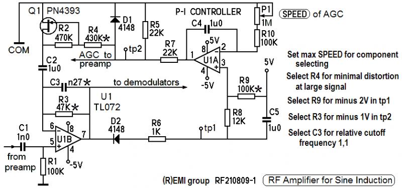

            RF amplifier
            RF amplifier with AGC
            The AGC is applicable only for motion metal detectors.
            The task of AGC is to maintain maximal not distorted signal at the output of U1B - pin 7. If the supply rail voltages are +5 V and-5V, an ideal rail-to-rail opamp would give output Vpp = 10V. However the not distorted output at TL072 is around Vpp = 5V only. When this is achieved, a DC voltmeter connected to test point tp1 shows DC voltage approximately minus 2V.
            Simultaneously with such a large output, the RF amplifier should give as much as possible less gaint. Thus, the AGC of LN preamp (see above circuit) provides its high gain and the preamp operates in a narrow band with minimal thermal noise. For this purpose, reduce resistance of the resistor R3.
            For convenience in the settings, potentiometer P1 is set at a minimum (maximal SPEED) to shorten the settling time of P-I controller. Selection of components starts at the very beginning without preamp. After connecting preamp with its AGC and both RX coils in TWIN LOOP configuration, select R3 until the voltage at test point tp2 be almost zero without TX signal. Palaver began when the TX is on :-)

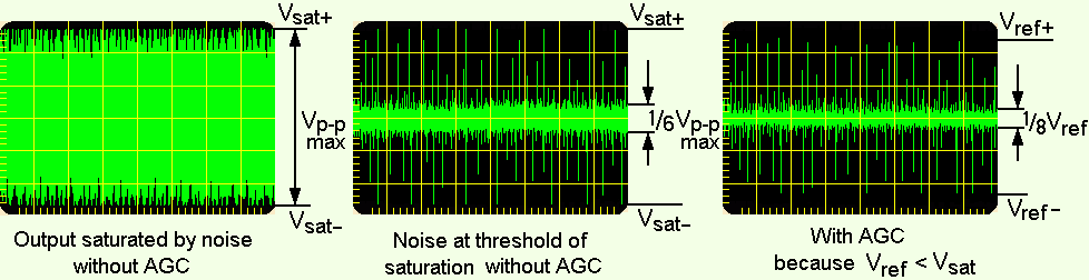

                When the possible gain of RFA is limited by noise in input, to reduce noise we need a narrow band front end. The required bandwidth for metal detecting is very narrow, no more than 12Hz. However when we use RX tank circuit for this purpose, we operate in a region where the phase changes very quick with frequency: from 0 to 180 deg at parallel LC tank or from +90 to -90 deg at serial LC tank. Conventional metal detectors can not operate steadily in the resonance region because reference voltage is artificial. When reference voltage is received by RX tank, phase difference remains the same, ie GND eliminiation and DISC setting not need correction.
                Let we calculate the gain of RFA limited by noise:
                For example we have RFA delivering maximal output swing (just before threshold of saturation) 5,6Vp-p, as shown in the attached figures. When AIR and GND signals are set by ABC to zero, we can obtain maximal undistorted noise voltage in output Vn=1/8 of 5,6Vp-p or 0,7Vrms. If we have in input of RFA noise density 7nV/rtHz and bandwidth is 10Hz, then the input noise is Vn=7E-9*10=70nV rms. Then the possible operating gain (without saturation) is A=0,7V/70nV=1E7 or 10 000 000 times, ie 140 dB. This is not realisable in practice because ABC can not suppress the sum of AIR & GND signals to zero, but even 70dB gain is a good value.
                Conventional metal detector often operates with AIR & GND signal in input of RFA more than 28mVp-p. That means the maximal possible gain of RFA is limited to A=5,6/28E-3=200 or 46 dB only.
                The left oscillogram shows an output saturated by noise because RFA has very high gain without AGC. In the middle figure gain is reduced manual untill we can not see saturation. The noise seems as a band having width 1/6 from saturating swing Vp-p max. However there is invisible part of noise, which is discovered by amplitude detector when we operate with AGC. Automatic limited noise seems as 1/8 width of referenced limits.

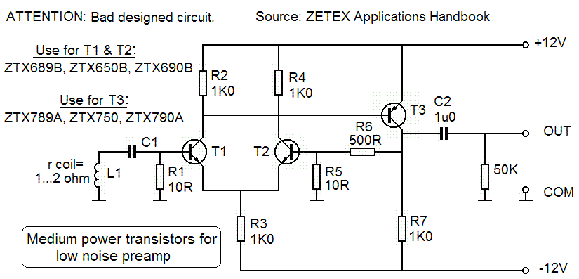

                  BAD DESIGNED CIRCUIT (quiz)
                  This quiz is: BAD DESIGNED CIRCUIT
                  Once upon a time, when there was an Eric Foster's PI Technology Forum at "www.insidetheweb.com", I made the following posting:
                  http://www.geotech1.com/forums/showt...eferrerid=2910
                  It relates to a bad designed circuit (see here below). The circuit was published by ZETEX, a company producer of transistors having excellent parameters. However if you are designer of excellent transistors, that not means you are able to design excellent applications with them.
                  Most interesting was, that when this bad designed circuit was published by the company in 90-ties, no need to use medium power transistor to obtain low noise figure because the company ZETEX produces an excellent low noise low power transistor ZTX214C. Despite now this model is obsolete, the circuit diagram shown above in posting #5 outperforms all low noise circuits with modern opamps.
                  The quiz is:
                  DO YOU SEE SOMETHING BAD DESIGNED IN THIS LOW NOISE AMPLIFIER?
                  NOTE: In the subsequent publications of this circuit diagram, ZETEX not shows values of resistors.
                    ANSWERS
                    The quiz is:
                    ANSWERS
                    1. NPN or PNP?
                    In the moment when ZETEX published the bad designed circuit (see posting #9), the company produces two excellent types transistors for low noise applications: ZTX348C and ZTX214C. They have equal parameters because are absolutely equal in design, but are made of different silicon material. Transistor 348 is NPN, and 214 is PNP. What follows from this difference? Transit frequencies are respectively 150kHz and 200kHz, noise figures are 4 dB and 2 dB and hFE are 250 and 350.
                    HINT: When you design an ultra low noise amplifier, you should use PNP transistors. However the long-tailed pair shown in posting #9 is made of NPN transistors.
                    2. "Short" or long-tailed pair?
                    (Term "Long-tailed pair" means difference amplifer. The term "short" is as opposite of it, ie amplifier with only one transistor:-)
                    The above circuit of differential amplifier contains two noise generating transistors instead one. That means it generates in principle 3 dB more noise than an amplifier with only one transistor.
                    HINT: When you design an ultra low noise amplifier, don't use long-tailed pair nor yet IC opamp with differential input. The best solution is only one transistor not only for low noise. The differential amplifier drains in operating point twice more current from battery. Even with one transistor, the optimal collector current for minimal noise is enough large.
                    3. Optimal collector current in operating point.
                    For minimum noise there is an optimal collector current in operating point Icopt. It is calculated by formula
                    Icopt=Ut*sqrt[ß/(rs^2+rbb'^2)]
                    where
                    Ut is thermal voltage kT/q = 25mV at room temperature,
                    ß is transistor parameter hFE,
                    rs is resistance of signal source, and
                    rbb' is secret transistor parameter "basis resistance". It is secret because producers avoid to publish it for SPICE simulation of noise.
                    The resistances of resistors in the circuit (posting #9) are so incompetent designed, that operating point of input transistor T1 is below 1 mA:

                    4. Filtering in input.
                    Why input signal should be passed by HF filter C1-R1?
                    There is an answer: To increase noise generated in input!
                    Note that noise generating resistance of signal source is only 1 ... 2 ohm. The designer adds to it the noises from R1 and R2 and twice the "secret" transistor parameter rbb' of T1 and T2.
                    Note that the circuit in posting #1 has no additional noise generating resistors. Only coil resistances generate additional noise to rbb'. Using potcore for L1, its resistance can be made only 4 ohm as shown in posting #4.

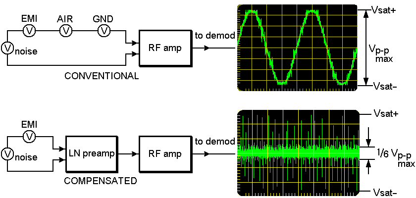

                          LOW NOISE PREAMP FOR METAL DETECTOR
                          In order a RX to be sensitive, the received signal from its antenna must be amplified before it to be demodulated. The amplifier that performs this task is marked as RFA (Radio Frequency Amplifier) because amplifies the radiated by TX frequency band.
                          The RX used in metal detector also needs RFA. The depth of detection depends largely on how much is allowed to gain RFA. However amplification of the AM signals is limited. The gain can be increased only until the signal at the output of the RFA begins to distort due to saturation. Some metal detectors have even an indication that saturation has occurred and operator knows how to adjust gain.
                          An RX used for metal detecting has in input besides its own thermal noise 3 more unnecessary signals:
                          -AIR due to the direct transfer of energy from TX to RX,
                          - GND due to energy reflected from the ground and
                          - EMI (interference) due to other sources such as power supply network.
                          These signals are relatively large compared to thermal noise so they limit possible gain of RFA.
                          The figure shows two cases for the development of RFA.
                          Above is the conventional block diagram of Front End. In addition to noise source, there are unnecessary sources of EMI, AIR and GND signls. It is shown slightly exceeded the permissible gain because the output begins to notice distortion.
                          As shown improvement in which manually or automatically compensate AIR and GND signals the entrance of the RX. Manual compensation is used in some mine detecting equipment. The operator has two additional buttons Re and Im (or Mag and Phase).
                          Since compensation in input allows to increase the allowable gain, it is added to one step LN (Low Noise) preamp as shown below. Displayed is output is situation when gain slightly exceeds the allowable value. It began to limit peaks in the noise signal. Visual impact in this case is that the noise seems like a band without a sharp borders, a width of about one sixth of the eligible scale in output.

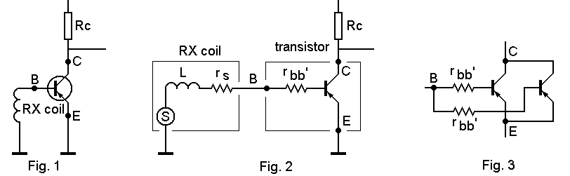

                              RESISTANCE OF RX COIL
                              Resistance of RX coil generates thermal noise. Each resistance connected in series to RX coil increases this noise. The circuit in Fig. 1 is an ideal configuration because there is no additional resistor connected in series to RX coil.
                              The equivalent circuit diagram of Fig. 1 is shown in Fig. 2. Resistance rbb’ is transistor parameter which can increase significant noise only if it is larger than coil resistance rs. However we can make rs too low despite this increases weight of RX coil.
                              An ancient method to reduce rbb’ is to connect in parallel two or more transistors as shown in Fig. 3. Now this method is not used because industry produces low noise transistors having rbb’<50 ohm. That means we can design RX coil for resistance 50 ohm as a good value for lightweight and low noise application.
                              However, if we have an RFA designed with IC NE5534, how to design optimal resistance rs of RX coil?
