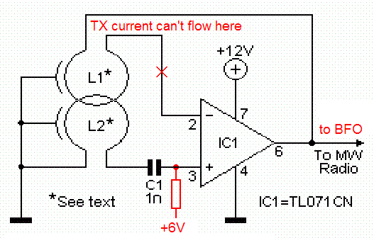

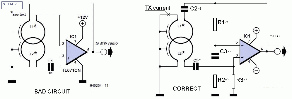

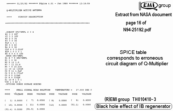

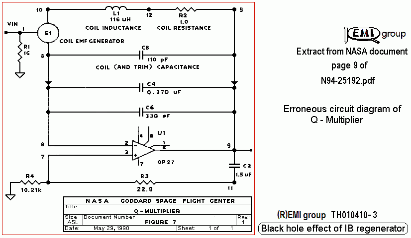

There was a joke set by the (R)EMI grop in 1st April about BLACK HOLE ANTENNA of NASA.
The joke is that there no joke:-). However there is an error made of NASA experts when they simulate by SPICE a wrong circuit diagram of Q-multiplier.

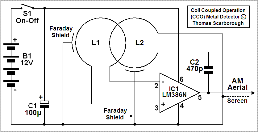

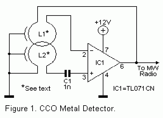

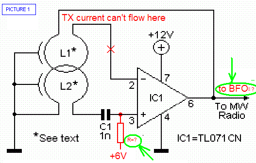

But let's start with something extremely simple - a circuit diagram of Rev Thomas Scarborough.
If you search this forum for "scarborough", you will find the following circuit diagram posted in 11-17-2006. Can you SPICE simulate it?
