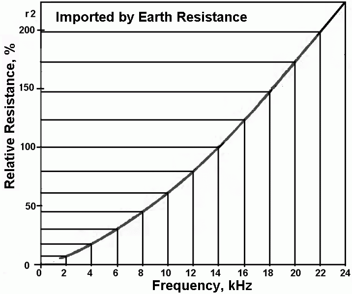

      With test basin shown above was tested imported resistance in RX and TX windings of a concentric search head designed to operate at 14kHz. Even in normalized form, imported resistances are different because windings in concentric coil differ in diameter. A winding with greater diameter appears relative near to earth.
      The diagram below shows imported resistance r2 in RX and TX windings in a DD search head at worst earth conditions.

        To measure noise resistance Rn of a winding (RX or TX coil) in sensing head and to calculate imported by earth resistance r2 (see circuit diagram in posting #1),
        we need a sine wave generator. It should be converted by a resistor R1 in current source as shown in attached here circuit. For measurement we need a potentiometer R2 with resistance 50, 100 or 200 ohm. Capacitance of C1 is selected for resonance at TX frequency. As AC voltage indicator we can use an oscope or an AC milivoltmeter.
        The procedure of measurement is as follows:
        1. At shown position of switch S1, change frequency of sine wave generator until AC voltage indicator shows minimum. We should increase sensitivity of AC indicator for accuracy. Resonance frequency should be near to TX frequency.
        2. Notice minimal voltage indication and then change position of S1.
        3. Rotate Rn until indicator shows the same AC voltage.
        4. Change position of S1 to measure with DC ohmmeter the resistance of potentiometer Rn.
        5. Measure DC resistance r1 of coil under test. We can measure r1 also with AC if take away the test basin and use described here procedure. The difference between two measured values of r1 shows how worse is influence of coil shielding.
        6. Calculate imported by environment resistance r2 = Rn - r1.
