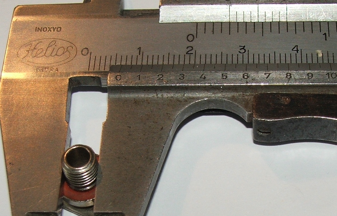

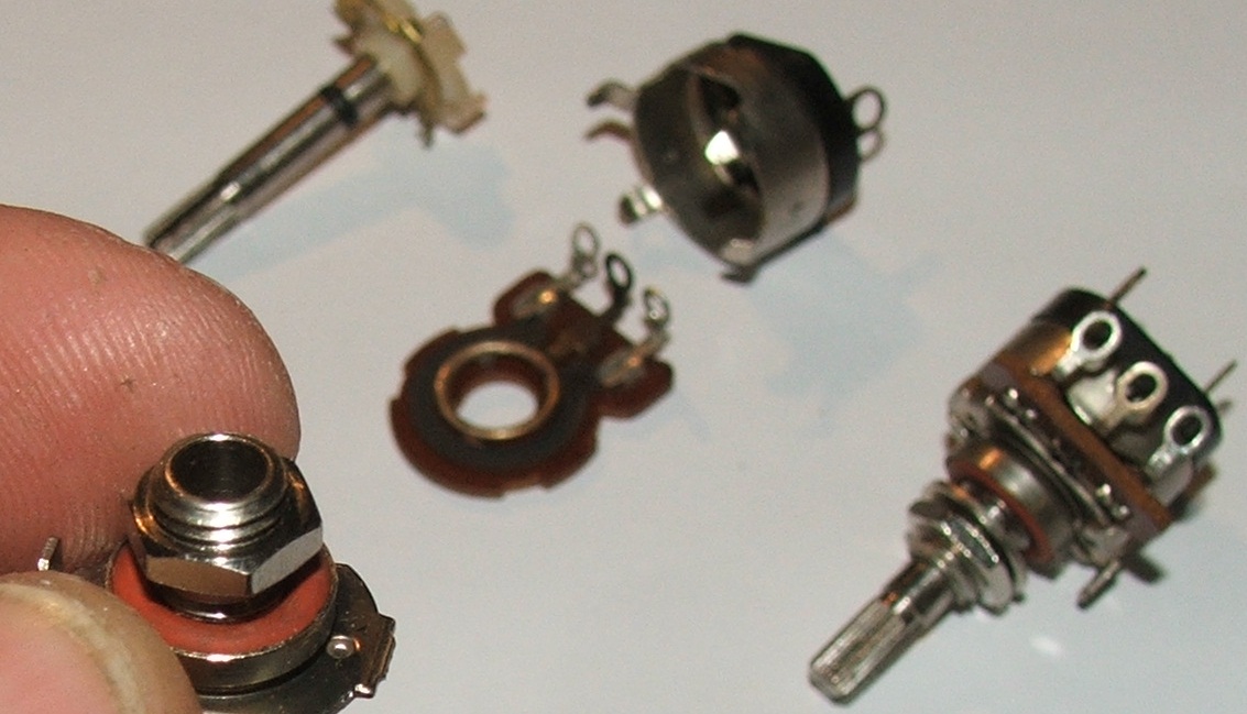

    Some time ago I bought those... to my supprise the have a O ring intern on the shaft and also a O ring at the outside.. the only problem is that they do not have a nut to fasten it..I have bought a tap for it.
    It are nice small potentiometers, only for the tune and on/off function.

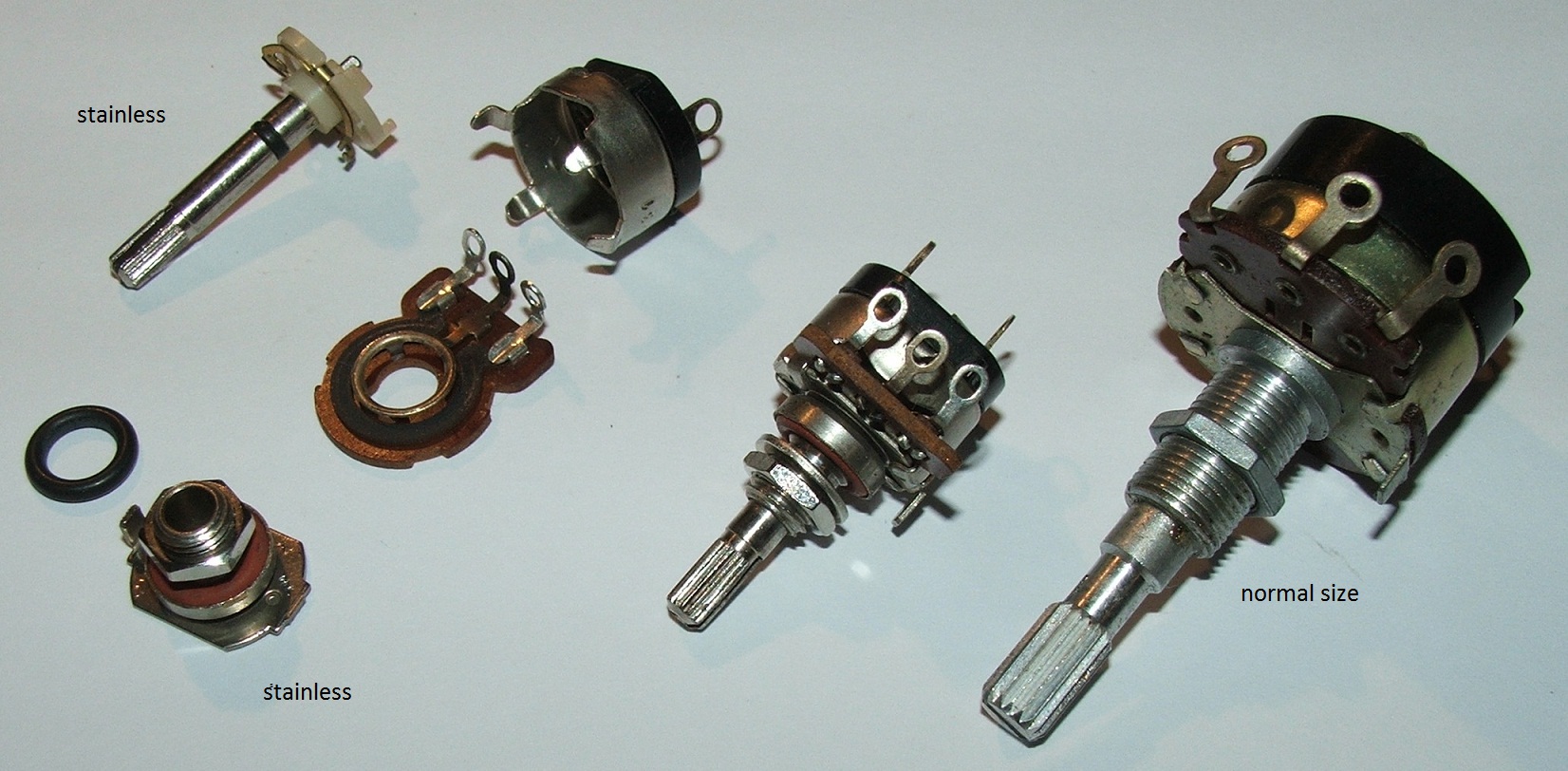

        Our sole source on those (US-made) pots recently jacked their prices up to $40 each (our cost!), so we were forced to get them custom-made in China for about $3. I think I spec'd 1k, 10k, and 100k with switches. So don't order those pots until the new pricing gets in the system, you'll save a lot of $$.
        The only thing special about them is they are stainless steel. They are not inherently waterproof, you need to use an APM Hexseal nut to accomplish that. White's has those, too.

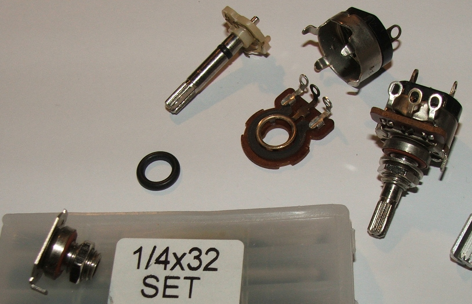

          Yes... not a problem to get pots.... but I think that this is a very nice pot for the money !
          look at the photo's, if you bay them there is no nut ! so a small problem... I also chance the red Oring for a new black Oring..

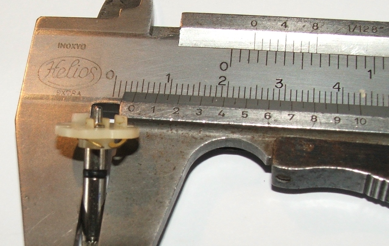

                Hello Mark,
                No the nuts are 1/4 x 32 . ( I think ) bought a set taps(look photo) and it seems to be the same size.

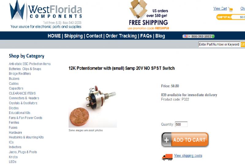

                      Thanks for all the info guys. Great pictures too. Thanks for the effort.
                        Where can I get the $3 Chinese pot that Carl mentioned?
