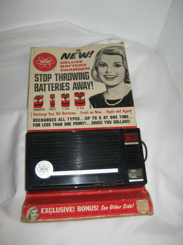

              In the 70's I got a miracle battery charger, same as the one pictured below. As mentioned, recharged batteries never lasted very long, and had a horrible tendency to leak.
              About 10 yrs ago I was running Ray-o-Vac rechargeable alkalines in my detectors, but eventually abandoned them because they were very sporadic... sometimes a battery would last 100 cycles, sometimes only 5. Now I use only NiMH.
                makes you wonder why they used a pretty female to advertise this product ha ha

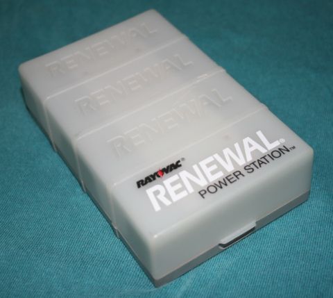

                    Hello I have the alkaline charger Rayovac model PS3, I charge some alkaline bat.
                    for wall clock, etc.,
                    But now I use new charger NiMH. and bat. 9v. sony 400mAh and Duracell 2650 mAh
                    Renew and Reuse Your Renewal Brand Charger!: Introduction and Backstory**: Introduced in 1993, the Rayovac corporation marketed and sold a rechargeable battery system dubbed "Renewal". It was unique because it used a rechargeable alkaline battery which is very similar to a regular "disposable…
                    Uploaded with ImageShack.us
