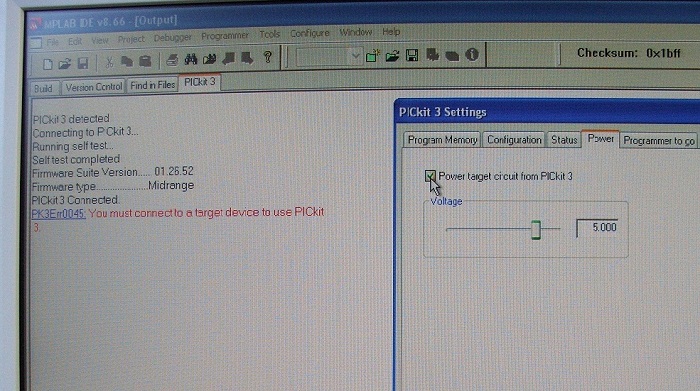

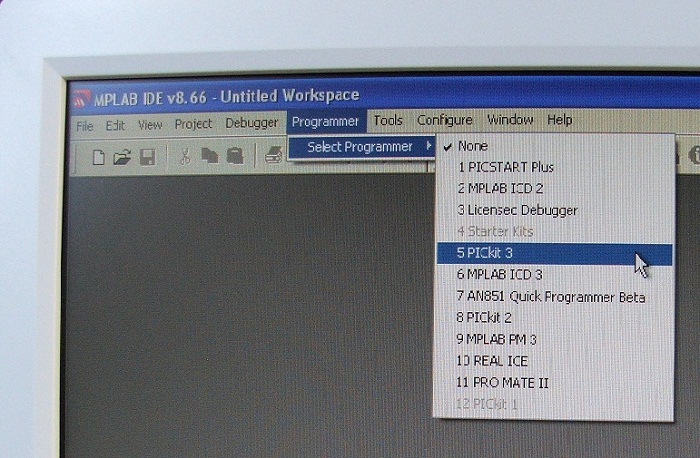

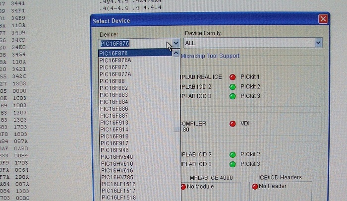

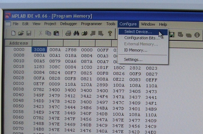

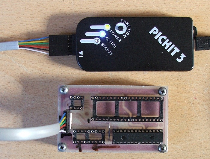

    As we have the same programmer.... not that I am an expert ( )...some photo's for the start..:
    First connect the programmer to the usb from your computer, then start MPLAB.
    You now get some errors, you must tell in Configure what device (chip) you use ,also in Programmer /power tell that it has to use the power from the programmer.
    The power can be 5volt or 3.3 volt !! it must match your chips power needs !
    In the File menu you can import a hex file, in the View menu you can see the hex file now with the tools in the toolbar you can program/ read/ etc ... the chip

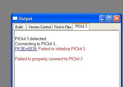

    When I try and connect to the pickit3 I get this error message
    PICkit 3 detected
    Connecting to PICkit 3...
    PK3Err0038: Failed to initialize PICkit 3.
    Failed to properly connect to PICkit 3
    I have tried all suggestions, run out of ideas now

      These PICKit clones need to have a driver loaded in order for the USB connection to work. I presume you have obtained and loaded the driver?

          ISP board
          Found a nice 3 page's info for a isp board, look at the pdf, only for 5 volt Microchip's !! no 3.3 volt Pic's !?

              When you install Mplab IDE, use the latest version, on first run it should let you update firmware - do it
              Although my pickit3 works fine, it sounds possibly like a USB issue, my USBASP programmer for Atmegas won't work if I have had itunes running - I have to logoff and on again without my ipod connected to make it work
              Are you using a USB hub or direct port ?

                  You may have an IRQ conflict on the USB port. Check Hardware Resources > Conflicts / Sharing in the System Information.

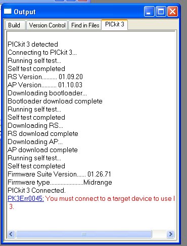

                    well i have good news and bad news
                    I have tried the pickit3 on another pc
                    with a clean install of XP and I have gotten
                    it to almost work with MPLAB 8.7
                    the pc is now talking to the pickit3
                    and it did the software upgrade.
                    it seems that my normal pc has some sort of usb problem
                    with the pickit3, my jdm programmer works 100%
                    just plug and play
                    Thanks to everybody for their tips, they have all helped me to get this almost working
                    just got to figure out this error 45
                    I have had a 12f683 plugged into the breakout box while trying to get this to work
                    I will do a write up of the results

                      Hello 6666
                      The error 45 ... look at photo 3 in the first post, the programm need to know what PIC is in the programmer, select the device you use in the long list PIC's. Do not forget to turn on the power, in the menu from the PICKIT 3, if you use a ISP board that has no power connected.

                          Hi all
                          I found the problem with the cable to the ISP board giving error 45,
                          you also have to tell MPLAB to power the pic from the pickit3 (thanks AP) also gives error 45 if not powering pic.
                          So from a direct port, Mplab 8.76 is now happy talking to pickit3 and reading from 12f683
                          I am very happy to .
                          all works now on 2nd pc with XP and laptop loaded with windows 7.

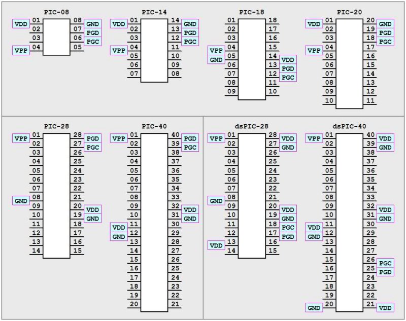

                          Found this handy diagram
