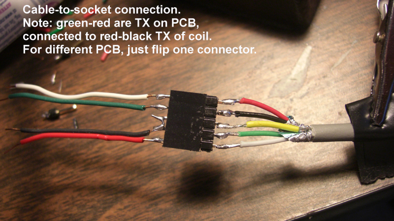

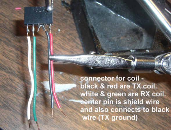

For testing different cables with different PCBs and different coils, I needed some solution match the coil wiring to the PCB wiring.

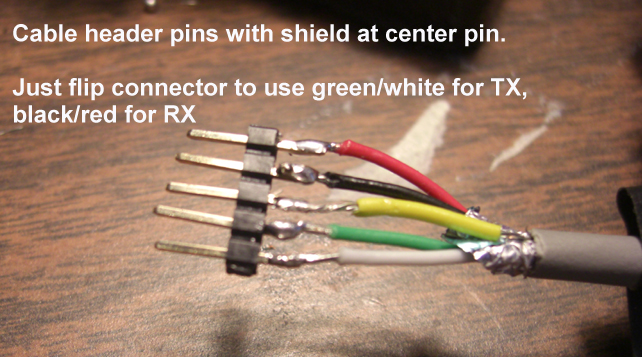

I have one PCB that uses green & white USB wires for TX coil and red & black for RX coil.
Other PCBs use the opposite.

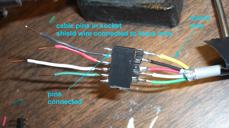

The special problem is that, at the coil end, sometimes the cable shield wire needs to connect to the black wire, and sometimes to the green wire, depending on the PCB.
Or maybe not. Do we really need to have the shield always connect to the TX ground at the coil head (since it already connects to the TX ground at the PCB)? Could we just connect it to the coil shielding? Maybe something to experiment with.

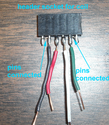

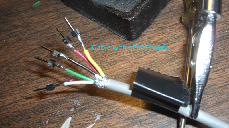

So I used some "header" pins and sockets to help choose these configurations more easily and match my various coils and PCBs.
Attached are some photos. Note that the cable shield wire is the yellow one and is free. I can plug it in to either end of my socket. Note also the end socket pins are soldered to the one next to them. That way I can choose which wire, green or black, is connected to the shield at the coil.
The socket wires are then soldered to the TX and RX coil leads directly.

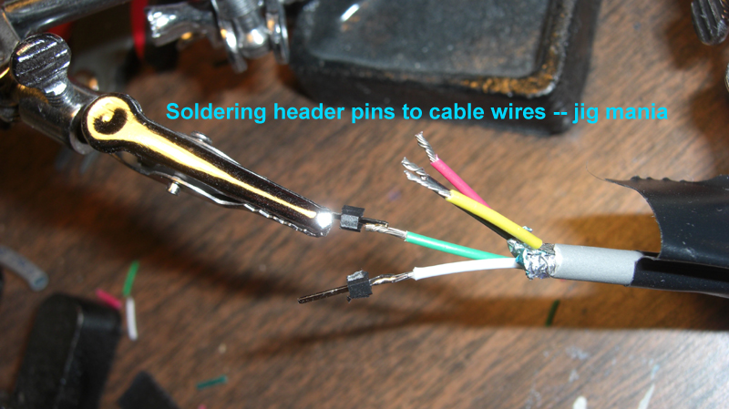

I'll probably find a better way to do this. It is actually awkward to insert the cable pins into the socket separately because not much slack to maneuver.
P.S. I loathe alligator clips that won't bite a wire because of gaps. I'm also not fond of these cheap solder jigs with two arms with alligators -- they are a pain to line up. We need jigs where each side holds something at a given orientation and height, and you can slide the two sides together on a track. Anyway...
