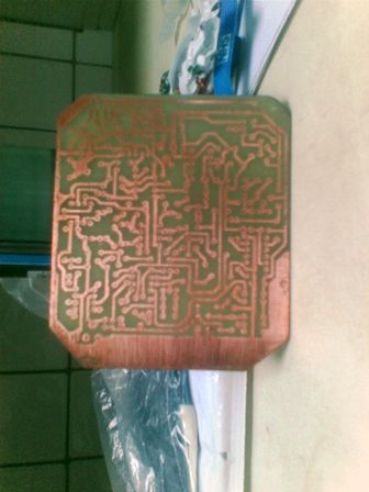

                          Using vinyl sticker as an alternate to magazine paper
                          Originally posted by Halo View Post
                          This method works well. The benefit is that you can finish a design and already try it out just a short time later. Double sided is a little more challenging.
                          If you have a laminator you can replace the clothes iron. It's easy to press too hard with the iron and get fat traces and the laminator just makes it easier.
                          1 square meter of vinyl sticker is no more then 5$. You can make pcb from it, entire your life (if you are over 45 like me ). You can see here how can you use this vinyl : http://www.youtube.com/watch?v=FtmJdCBjwXY and many more about it (including a Sprint Layout 5.0 very beginner tutorial) at : http://electroni-city.com
