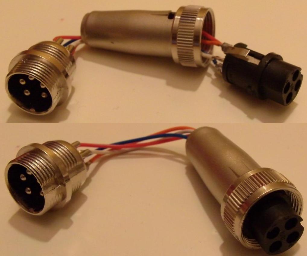

                        hello
                        finished my adapter
                        so i can use every selfbuild coil with original one
                        next is adapter for original coils to selfbuild md
                        tested already works good only need some insulation

                        regards bernd
