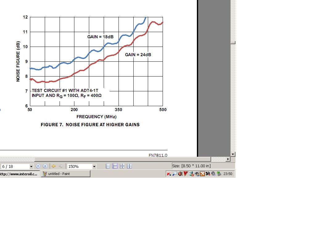

    This is a fairly new good opamp - check out the NF though
    S
      Noise figure isn't usually applied to metal detector design. Besides, I can easily get an outstanding NF with a lowly NE5534 opamp.
        Sure, Im aware NF isnt often raised - which is odd to me.
        I cant explain why the guy in the nat semi vid sees ~6dB NF on his amp.
        I looked at the 5534 spec - your right 1-2dB should be reachable with 5k source res..
        Sub 2 should be fine. I get jittery when I convince myself of 6 plus
        Im missing a few basics somewhere - gotta sharpen up - its been a while since I did my cellular stuff.
        S

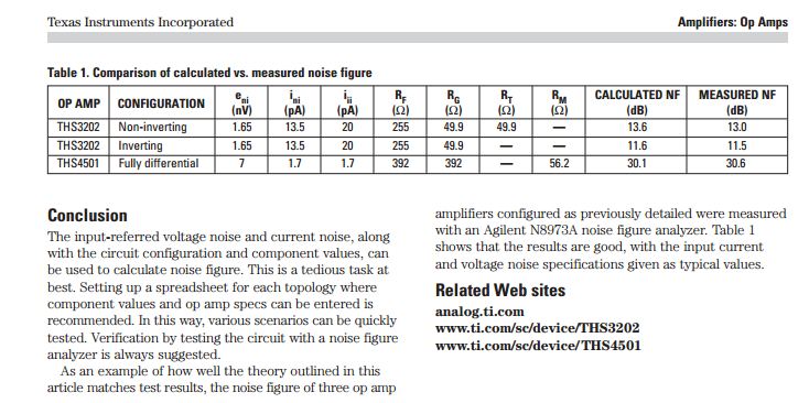

              Saying the above this Ti paper leave me cold a bit. These NF are high,

                            1. A typical PI front end; a 300uH coil has a 680-ohm damping R and a series 1k clamping R with clamp diodes; applied to a NE5534 with 4nV/rtHz.
                            The damping resistor and diodes make no difference, only the 1k series. It has a NSD of 4nV/rtHz, same as the input-referred noise of the opamp. Ignoring the noise of the opamp's feedback resistors (which I can easily make insignificant) the noise figure of this preamp is 3dB.
                            2. Same PI front end, but the series R is magically reduced to 100 ohms.
                            Despite the fact that we now have less noise than with #1, the noise figure of the preamp has increased to 10.3dB!
                            3. VLF front end, where the RX coil (10 mH/10 ohms) is applied to a NE5534 preamp.
                            The noise figure for this case is 19.9dB. Holy Smokes, this sucks! Or, it just doesn't matter.
                            - Carl
