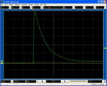

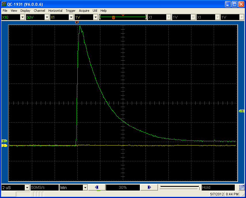

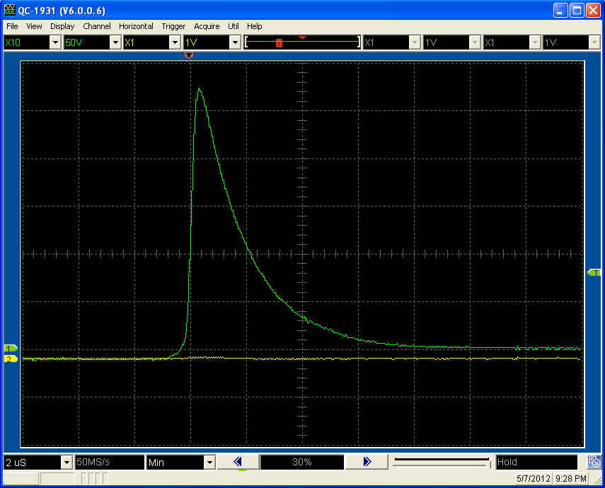

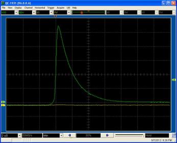

        Reposted graphs
        Thanks for the replies, I've posted the graphs in nice PNG format.
        These are the actual coil spikes, on the coil (50V per division)
        Notice one has a slight ring right at the beginning, this I believe is what makes it very sensitive to wet sand, and makes a huge difference..
        This ring will occur regardless of coil damping,..increase or decrease the damping, the ring will still be there..
        THe different mosfets required different damping resistance..the damping resistance seems more to do with mosfet than coil.. The fast mosfet needed more damping (250 ohm), the slower mosfet needed 330 ohm.
        damping is selected based on what is happening after the amplifier..which shows up any slight ringing. Again, these graphs are of the coil spike at the coil.

          Hi Tec,
          Don't forget you have to look at the output capacitance (Coss) specification of the mosfet as well, lower is better. From the damping resistance you required it sounds like your 'faster' mosfet has a greater output capacitance which is what is slowing the whole system down. The sensistivty to wet sand is probably because with the extended decay curve your MD is no longer taking the samples in the correct place.
          Midas
            Midas, I think you are onto something. Coss is usually higher with MOSFETS with lower Rdson, and in fact Rdson is ridiculously small compared to the coil resistance already, everything below 1/10 of coil resistance is insignificant and it is not going to improve anything by getting any lower. It is the off state that generates pulse, not the puny Rdson.
            Tec, you have ringing, and it surely messes up your reading. Trouble with ringing is that resonance changes due to ground proximity effects, and you get false reading. Hairy parts are moving left and right and samples are wandering, just as Midas says.
            So far I thought Rdson is ridiculously small for MD purposes, so what?!? Now I know better. I'll seek some older MOSFETs for my builds. Thank you.
