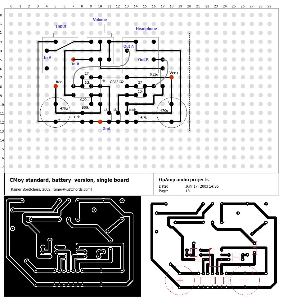

          hello
          here my work from last hours
          this is first time i made a pcb by myself with sprint layout
          if somebody could check it were nice
          p.s. if it works i will share for sure
          more p.s. i think i could make it smaller had take wrong size for headphone jack arrrr an some resistors could stand elkos are to big

              hello sven thanks
              know this links already read all this sources some weeks before
              but i think i can do my own complete for under 20€
              with a little bit of diy work
              i need some training in sprint layout and reading shematics
              i think the kits on ebay are sold to expensive
              the example calculation on jds electronics is only right when you order expensive parts from surpreme electronic warehouses
              and single pieces
              and if the foreign offers (abroad from EU) are over 21 euro i have to pay import tax and service tax to the german Zoll
              but thanks for your help

                I agree you can easily build one yourself cheaper, I have saved these websites a few years ago when I was interested in building my own as well. Just never got around to it.
                  1) I've never heard a detector that had such weak headphone output that it needed an amplifier. You aren't going to hear anything amplified that wasn't there before you added the amplifier. In fact, you'd probably end up turning the amplifier down so far that the output would be the same as what it was without the amplifier. (Remember, most metal detectors have speaker-level output, so you have to turn the volume down, not amplify it, for headphones.) If the environment is so noisy that you need more amplification to hear the tone, you're probably risking deafness. (Why are you detecting behind a running jet engine?) 2) An LM386 makes a much simpler circuit - basically a volume control, 1 battery and a few capacitors. (The "power supply circuit" is a battery - no other parts.) And it has much more output. The other advantage is availability - in the US, even Radio Shack carries it (for $1.69).
                    True, however, for new DIY builds you may chose whatever audio PA you wish, and cmoy just nicely fits the bill. OK, not in every build.
                    LM386 is not exactly a favourite for headphones due to its notorious hiss, and it draws quite a lot of current.
                    Too many MD-s have significant DC offset at audio output, and somehow it seem to be the most neglected part of them all.
