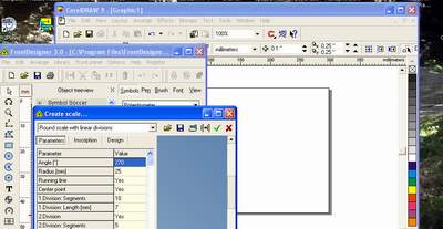

      Hi.
      I tried the previous version of this:
      You can draw with it your customized scale, print it on a sticky-paper, then apply on it a clar plastic adhesive film.

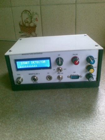

          Managed to make my first front panel decals although only tags to say what each thing does can only get better as its a learning game for me.
            I presume nobody prints there decals on here unless they do as I had to do, recommend coral draw, was like a lost sheep or fish out of water, but managed the basic tags using a housing I had already made.
            Next project shall make the box first from drawings using coral then decals, that way should be easer.
            Main diffecuilty that was experienced was matching sizes from my hand drawing to coral so that everything matched to fit facia on final fit using one complete over head projection film.
            But hey them who dares wins, done it, although basic labling its works for me, can now only get better as I learn the true power of coral draw.
            Very suprised indeed how quite this thread was, with all the projects thats going on here, really thought that interest would flow steady with such a must have knowledge.
            It makes a big difference to the end result to have controls that actually say what they do.
            I desided on using overhead projection film for 3 counts, its quite cheap, can get 50 A4 sheets for £7, its robust therefore can be man handled and should last the life of the machine and finally works very well with laser.
            Ive also bought some other type film that can be used with standard inject but not tryed yet, downfall already is the price £7 for 10 sheets plus its alot thinner, (size dosent always count, or so says the ladies), so time will tell, mainly bought that incase colour is required as my laser is only mono.
            Didnt use decal transfer type paper purley because of price, its takes it a click further out of the bugget of diy manufacturing for either same or maybe slightly better result.
              Hi
              Heres a pic of my first try at decals, will make changes in the fucture to it, the housing is now ready to be sprayed, all of which will be gun metal gray, front panel stays white.
                Nice work!
                I can suggest you methods i've been using for longer period: Front Designer 3.0 and Corel Draw 9....
                To make my job faster and easier; usually i "make" decal elements separate in Front Designer and than simply transfer them into Corel Draw by Copy&Paste!
                The rest than is easy; Corel is EVERYTHING man need in such jobs!
