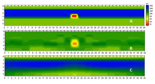

    At the picture You can see geoelectrical model result's of inversion for standart
    and transformed(to pure anomality) ERT data.
    A. Geoelectrical section with small buried object. For this section I calculate AMN and MNB data. And add 5% noise. Next I convert It to 4-electrodes arrays by two ways.
    B. Result of AMNA array inversion (AMN-MNB). The data was generated from two (AMN and MNB) arrays. True anomality data free from layered host. Inversion RMS 6%.
    C. Result of standart data AMNB(AMN+MNB, Schlumberger) array inversion. Inversion RMS 1%.

    The using of Half-Schlumberger array (Pole-Dipole array) and applying of D-transformation (AMN-MNB) is a very good way for visualisation of small buried objects (vertical 2D ERT).

    The using of D-transformation in 3D ERT or multiple 2D Cross-sections (4D) ERT will it help for making images and bird's eye view map, appropriate for archaeological research, which can be displayed with ZondRes3D or RES3DINV?

      The main problem for D-transformation is inversion of these data. It negative/positive and have relative small values. But it have great sensitivity to local objects.
      Using of 3d software needs very dense observation survey(>10000 readings) for good results. If You have same sets we can try test software with Your data.
