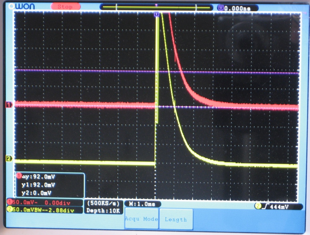

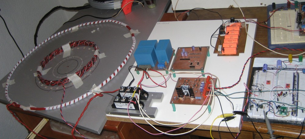

                      TDEM project update
                      Just a small update.
                      I have found an active partner on this R&D project. Together, we have made a number of LTSPICE simulations to check the validity of our design and timings.
                      We have now setup a first table-top prototype of the TDEM system delivering good-looking signals and decay curves with reduced voltage and currents.
                      The timing generator, signal processing and data storage firmware (running on an ARM LPC2148 from NXP) is ready to be tested on a prototyping board
                      See the two pictures attached.
                      Willy
Name:	Coil and board_06-09-2014.jpg
Name:	TX_Decay curve_A and B.jpg
