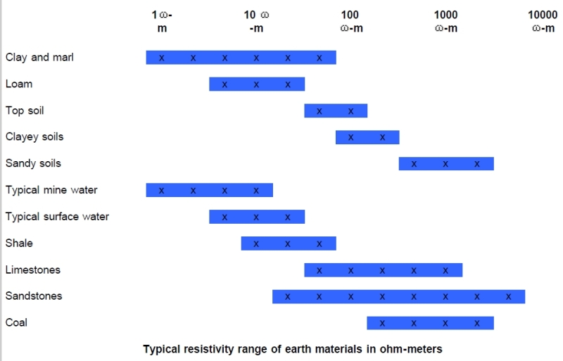

    any one can help me plz i wont to know how to understand these image what the color mean how to Analysis it
    her is a picture
    Analysing resistivity image, is important to know corresponding value in ohm per meter for each color /color scale below in picture/.
    The color by itself is doesn't matter.
    Yellow color does not mean gold.
    Materials as water, clay, metals, alluvium have low resistance and are represented by cold colors by this scale.
    Rocks, caves have high resistance, and are represented by hot colors.
    In this picture the pipeline is shown as blue spot (25 ohm/m).

          How can differentiate between metals and soil, clay, water, if they all contain low resistance Does this mean that in the depths if I find cold colors, could be metal and another question plz
          How Ames between caves and rock layers if both contain high resistance ?
