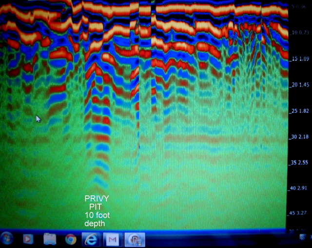

    Well after another year and a lot of work have a unit field tested. Have found many dumps, trash pits and privies. My hobby is looking for old bottles. I have relocated to the Augusta Georgia area and have a pit to dig on Saturday that I found with the radar.
    Depth is determined by type of soil. Here in Aiken I can easily see 10-12 feet down. This unit operates with a center frequency of 500MHz; will have a 250MHz unit done soon. Files can be saved in .sgy format fro post processing. Have a few filters built into the windows and android software.

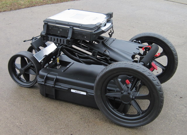

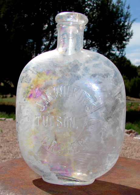

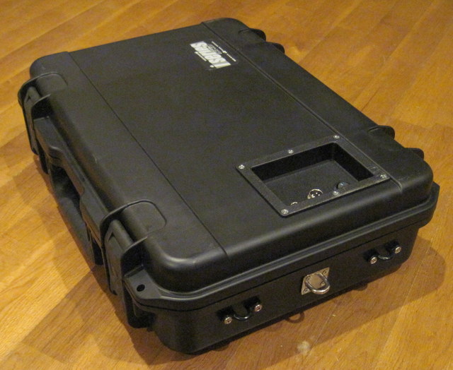

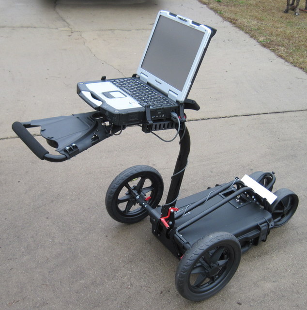

    First picture is unit by itself can be dragged across the ground, second is cart system ready to use, third is cart system collapsed for storage/transporting, forth image is privy "1880 outhouse" see through 3 inches of asphalt, last image is one of the bottles found in the pit "only known example of J.M. Wilkins Grocer Tucson A.T." ARIZONA TERRITORY!!!!

                      My cart works well over rough terrain and the wheels are large enough. My unit detects voids, tunnels, plastic pipes and drums as well as a host of other anomalies. I will be updating my website soon with screen shots of many different detected items. Also I have lowered the price of the antenna/electronics to $3995. This may not be affordable to you, but I believe it to be a great value.
