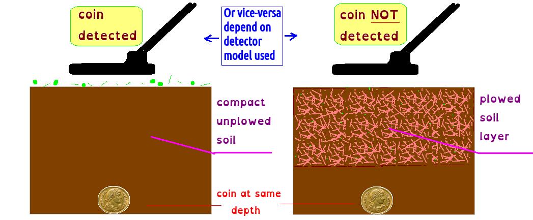

            OK. But in present case we have two layers.
            Only top layer is disturbed ground by plowing.
            Bottom layer, where coin is located, remain intact and soil around coil undisturbed.
            So "halo effect" should remain intact too, along with detecting depth, but is not.
              Knowing lazy detectorist (me), who avoid to dig week signal which, by past experience,
              lies deeper than 30cm. On pretty productive nearby piece of farmland he regularly
              perform detecting exercises. When field is unplowed there are a lot of deep weak signals.
              After plowing all such signals disappear and appear again after soil at rest 1/2 year or so.
              Interesting observation.
              But obviously (past experience too) plowed layer is somehow presenting obstacle even when in lower layer there is "hallo" effect presented.
              I guess it's because of the dispersive nature of plowed layer.

                  Dug soil swells by 30% so over plough ground you are up to 30% further away from your targets.

                    In this case most deep targets are left for the future generations. I always warn my customers to forget about depth in freshly plowed arable land. In such case not only the depth is inhibited, but also the discrimination becomes more erratic.
