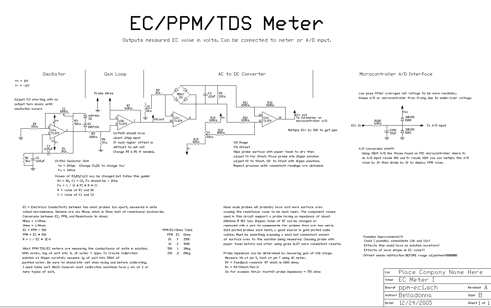

                          Carl, here is some more info I found on the I-net.
                          and cleaned up schematic
                          Thanks for your input in advance.
                          Sincerely
                          Bill, becoming not so, "Lost Adams"

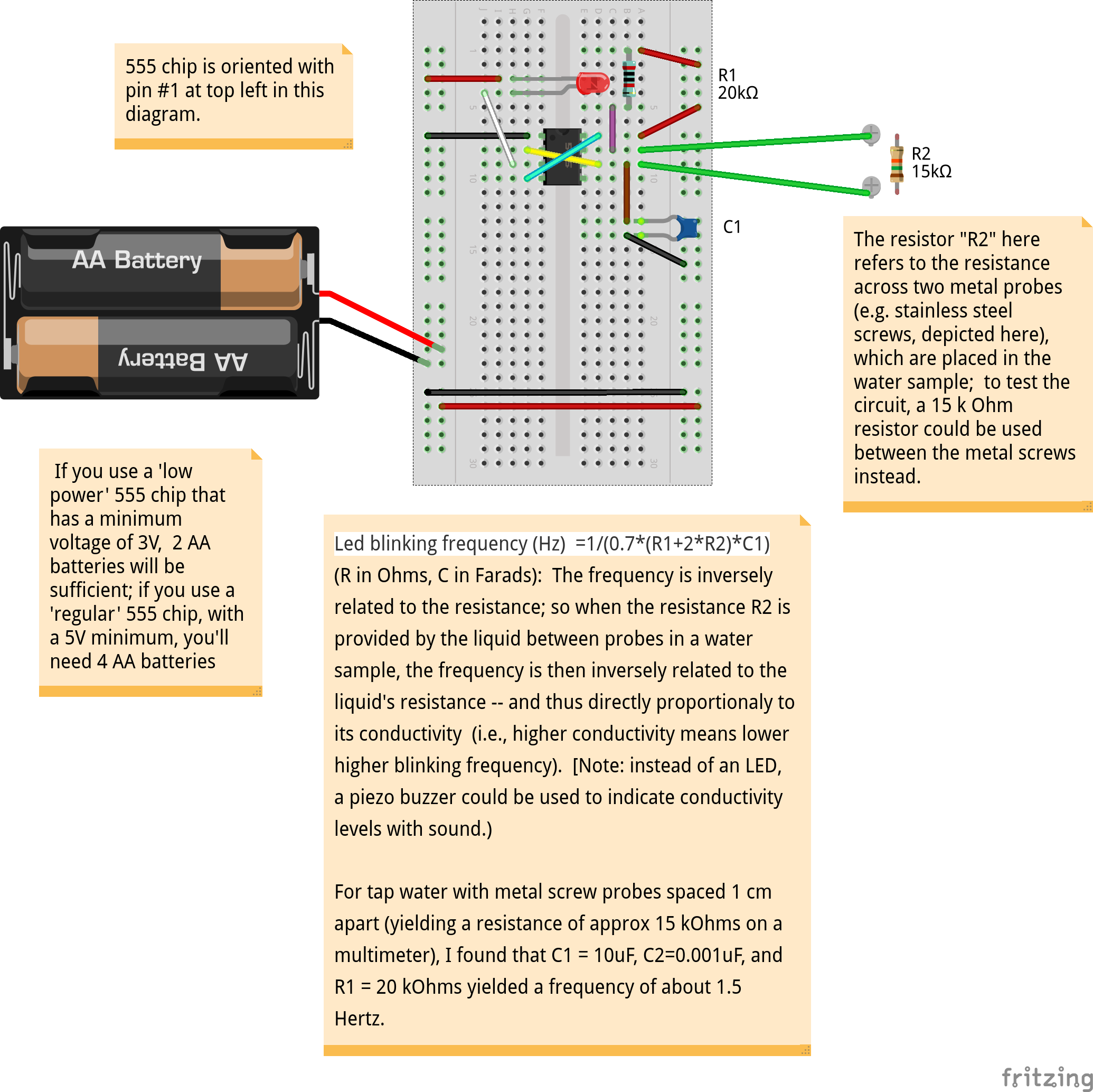

                            Hurray Gettin Close!!!
                            AND
                            this seems to be most similar to the original PM articles circuit. It's from a MIT 2014 workshop.
