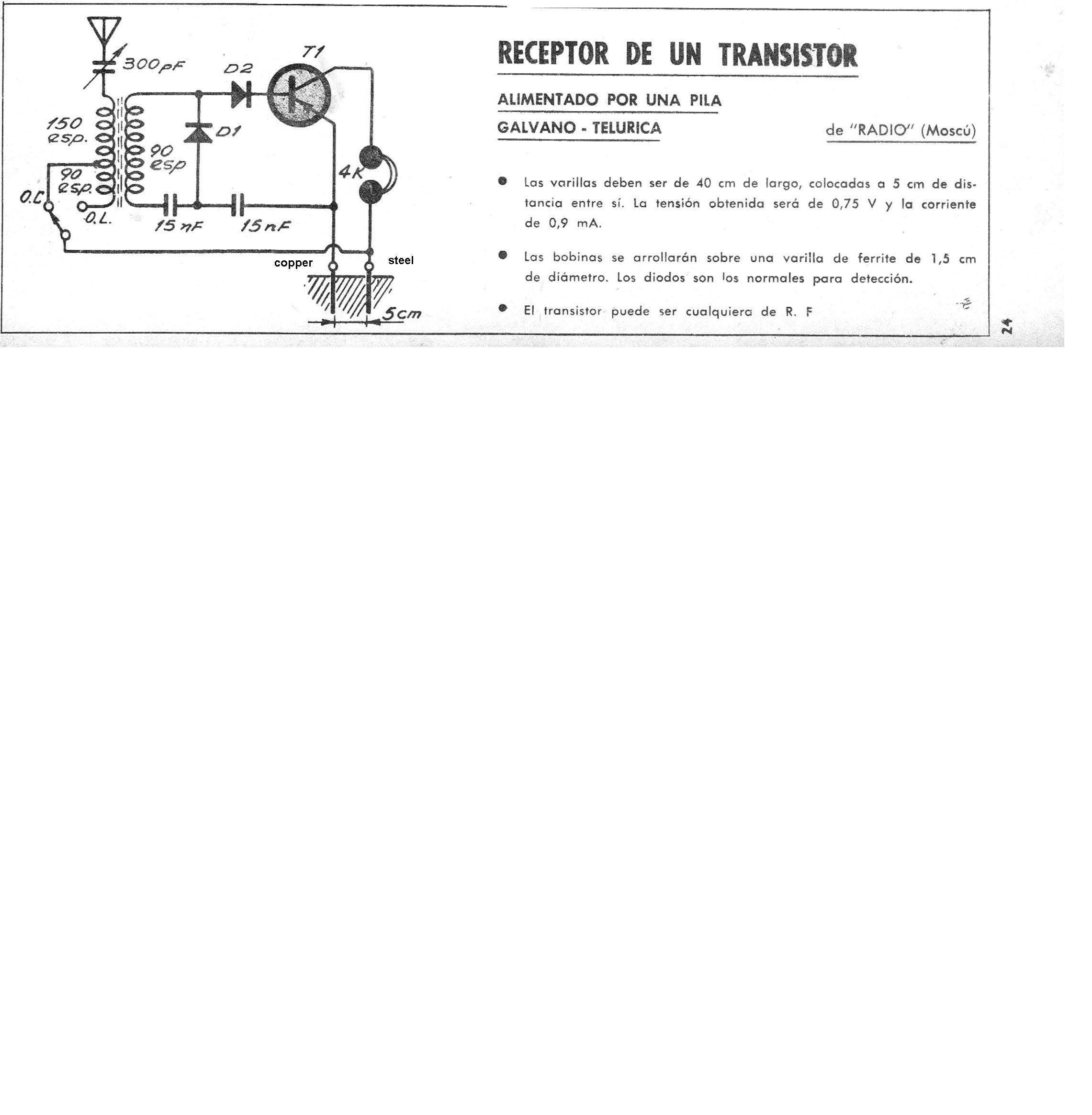

          Self potential in Galvano-telluric radio
          Thanks, Bill
          In the same way, here a radio wich works with two electrodes of different metal, steel for negative and bronze for positive. The pair generates around 0.75 V. Think this arrangement explain too why metal buried for long time works as battery. Parts of text are in Spanish.
          Esteban
