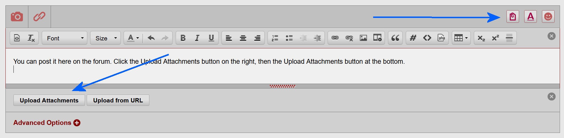

          • You can post it here on the forum. Click the Upload Attachments button on the right, then the Upload Attachments button at the bottom.
