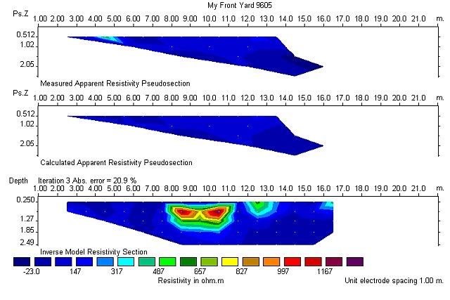

    Here are some Printouts of the Earth Resistivity Surveys I have Been doing in my front yard using the FREE software from a couple of posts down.

        Klaud, I was the one who posted the Links to the FREE Software a couple of threads down. I'm not sure what you are trying to say about using the 3D software. If you have downloaded the File on the Geotomo site titled "Coursenotes.pdf" and read it you will see that the 3D resistivity layout requires Hundreds of DATA Points and is Very Labor intensive not to mention requireing a Restivity Meter and DataLogger of some type.

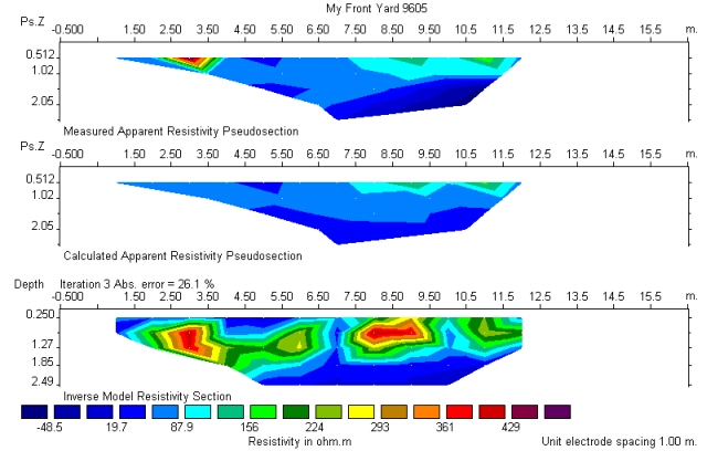

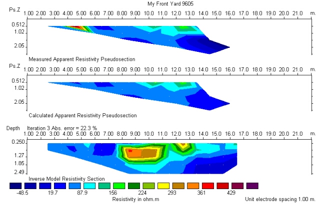

        What my intention was by posting the 3 Pictures was to Stir Up some interest and Possibly get some questions and or responses from others who had tried this software with whatever Meters and or Loggers they have used.
        Also, what types of Grid/Electrode patterns they have or are using, ie. Werner, Dipole Dipole, Schulemberger, or ??? and what their findings were. Did you dig the target after identifying it by which ever survey method or ???.
        What types of Equiptment was used for the survey?
        What I used to aquire the Data for the Pictures was an OLD Keithley VOM meter that had .0000 resolution on the 20m ohm DC amps and the same resolution on VDC.
        After the 2nd time doing the survey on the same 20yd line, First with Dry ground and Second with apx. 1 qt. of water poured around each data point I compared the results. What I found was that Three or four data points showed the lower resistivity WET Halo Decreasing with Depth. Or in other words It appeared as an elongated JUG down. This is what I had expected to see and it showed me that the data aquisition method and the software were producing PREDICTABLE Results.
        After I had compleated the 3rd Survey over the same Line I discovered that I had been moving the Probes in an Incorrect Sequence, and so on compleation of the correct Sequence I ran the new data with Sequencial Numbers in the Data File and GOT an 81 M long printout that said that I had entered 80 Plus Electrode Points. Well I KNEW that I had only Driven 20 Stakes 1M a part and that running the correct sequence of electrode positions gave me 65 DATA Points. I found when I changed the Sequencial Numbering of the data points to numbering the data points sequencialy for each different a=1, a=2, ... the printout SHRANK Back to 21M and the Measured, Calculated, and Processed data picture LOOKED more Like the ones in Dr. Loke's Manuels.
        This let me know that I was BEGINNING to Catch on to the Concepts and Methods being explained in the Texts and the Help files.
