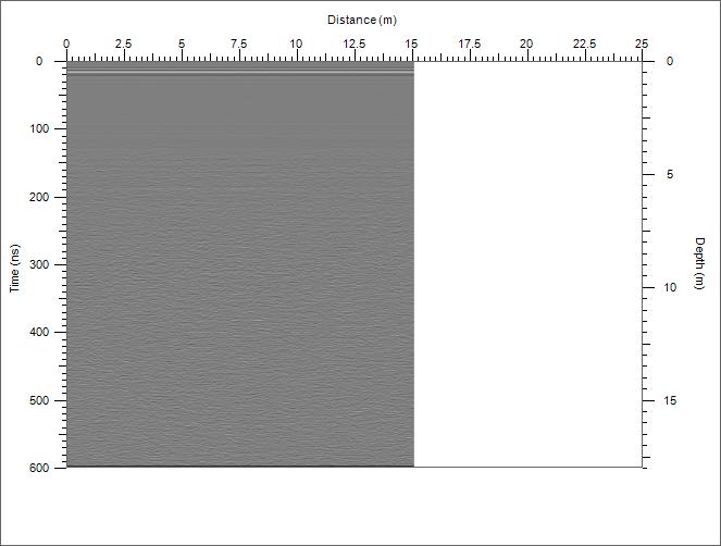

    Hi Valchev,
    what is the vertical scale of the radargram?
    If you apply a little bit of stacking your SNR will improve considerably.
    I cannot see the air gap between the two concrete blocks, neither can I the concrete/air interface on the blocks supports. You could apply a little bit of R2R gain to improve that area as well.
    Could you post how the signal looks like in o-scope mode with the proper scale? I have seen your software can do that.
    Keep the good work!
    RA
    • Oh, another thing,
      Are you using bluetooth to transfer the data?
      I didn't notice any cable from the antenna to the laptop.
      If that's so, does it work reliably? I mean, 1.6GHz antenna will most certainly go up minimum to 3.0GHz disrupting the 2.4GHz band.
      Interesting, very interesting.
      RA

        Hi gwzd,
        The vertical it is equivalent to 1m. Treasure hunters are not scientists, the picture must to be clear, due to this my software do not show horizontal continuous layers, show only changes in layers and local anomaly.
        I am new in high frequency GPR technology, if you know a examples similar to my or better , if possible share the links, but not advertisement , only technical data, as Bill512 wrote in his post 16:

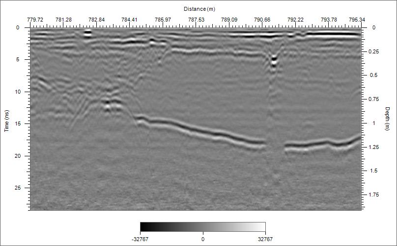

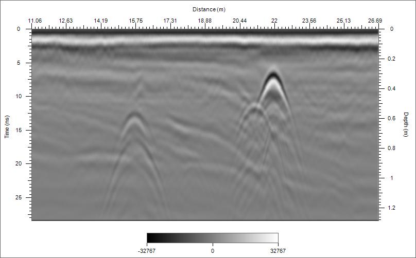

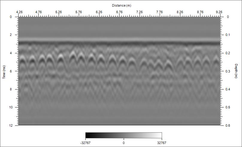

            I'll try to be as clear as possible.
            The first picture shows our antenna GCB-300, 300MHz center frequency ground coupled antenna detecting several pipes and conduits buried at 0.3, 0.5 and 0.6 respectively. The sharp one is a metal one, the one next to it is a plastic one filled with water and the one alone is a plastic one filled with air. The soil type is a mixture of sand, gravel and the grass with organic soil at the top. This pipes have been buried there for more than 6 years now and therefore you cannot see the disturbed soil, it has had time to compact again.
            The second picture shows our MA1500, 1.5GHz center frequency ground coupled antenna detecting the rebar mesh of a concrete slab, you can also see the bottom of the slab. The rebars are standard 8mm ones placed 200mm from one another. The start of the trace has been offset to clearly see the start of of the surface and better assess the depth to each individual rebar. The material is obviously concrete, and it is laying directly on the floor, that can be seen clearly.

                      Pipe and rebars are best metal objects for GPR,
                      Two of the pipes in my example are not metal, and that's on purpose to show our trainees the difference, but as you can see they were detected without any problems. I have a customer in Ohio that searches for gems with our radar, it is not metal neither, but it is definitely a treasure.

                      Absolutely, see the attached picture of a section of a road in Italy, taken with our MA1000, 1GHz ground coupled antenna. It shows the asphalt layer deterioration, the sub-bottom of the road, the digging of a trench and a sewage pipe. Pretty impressive for such a conductive area such as northern Italy, Ah?! I have many examples with all our antennas, some with GSSI that we have worked at lot with, some Mala Geoscience and even a couple of Sensors and Software, although we do not own a radar of the latest.
