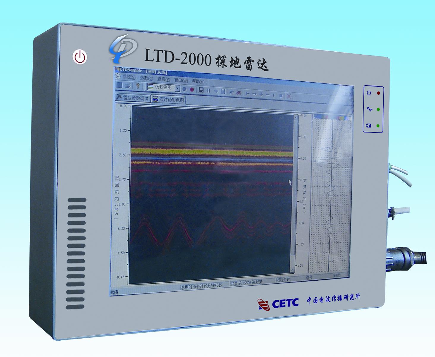

            I wish to tell you more.
            I want to show more informations, but there is always some net problems with me. I do not know how to upload the pictures. I am glad , if any body tell me. I also wish anyone to give your valuable idea on my GPR.
            I show some specifications here:
            Technical Specifications of LTD-2000 GPR System
            Antennas: Compatible with all LTD antennas
            Number of Channels: 1
            Dimension: £336´244´75
            Weight: £ 5kg
            CPU: Intel PⅢ 1G
            Internal Memory: 256M
            Hard Disk: 40G
            Display: Enhance 13〞,1024´ 768 resolution
            Input Power: 12V DC
            Data Acquisition
            Operating Modes: Free run, survey wheel, point mode
            Performance Factor: 160dB
            Pulse REP. Frequency: £ 128KHz
            Time Range: 0 to 5000 nanoseconds, user selected
            Number of samples per scan: 128 to 4096, user selected
            A/D Converter: 16bit
            Horizontal Sampling: 8 to 128 Scans per second, user selected
            No. of Stacks: 1-2048, user selected
            Clock Synchronization: Internal crystal
            Programmable time Variable Gain (TVG): -10dB~+70dB
            Antenna
            Shielded Antenna: 100MHz, 300MHz, 500MHz, 900MHz, 1000MHz
            Unshielded Antenna: 25MHz, 50MHz, 100MHz, 200MHz
            Horn Antenna: 1000MHz
            Operating Condition
            Temperature: -10℃~+50℃(Operating)
            -40℃~+60℃(Storage)
            Humidity: +40℃, 90%

                    At present the market price 35000 USD. I think the price is high than valchev's.
                    If any one have valuable comment , Please tell me.
                    Very thanks!
                    • #85

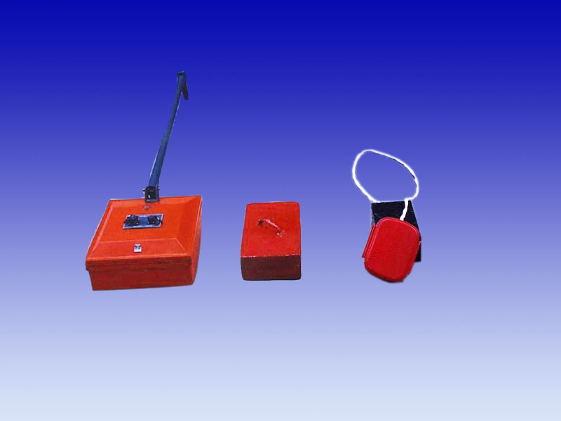

                      I show my GPR pricture.
                      I show more about my GPR.
                      I will be more happy if any one give me valuable comments.
                      • #86
                        valchev,
                        any comment?
                        I think that I can not coment "China Research Institute of Radiowave Propagation".
                        It is interesting for me to see photo picture of "Survey image of Underground soil cave group " from picture.pdf
                        • #87
                          Very thanks!
                          way to high to be competetive.....not my preference.......

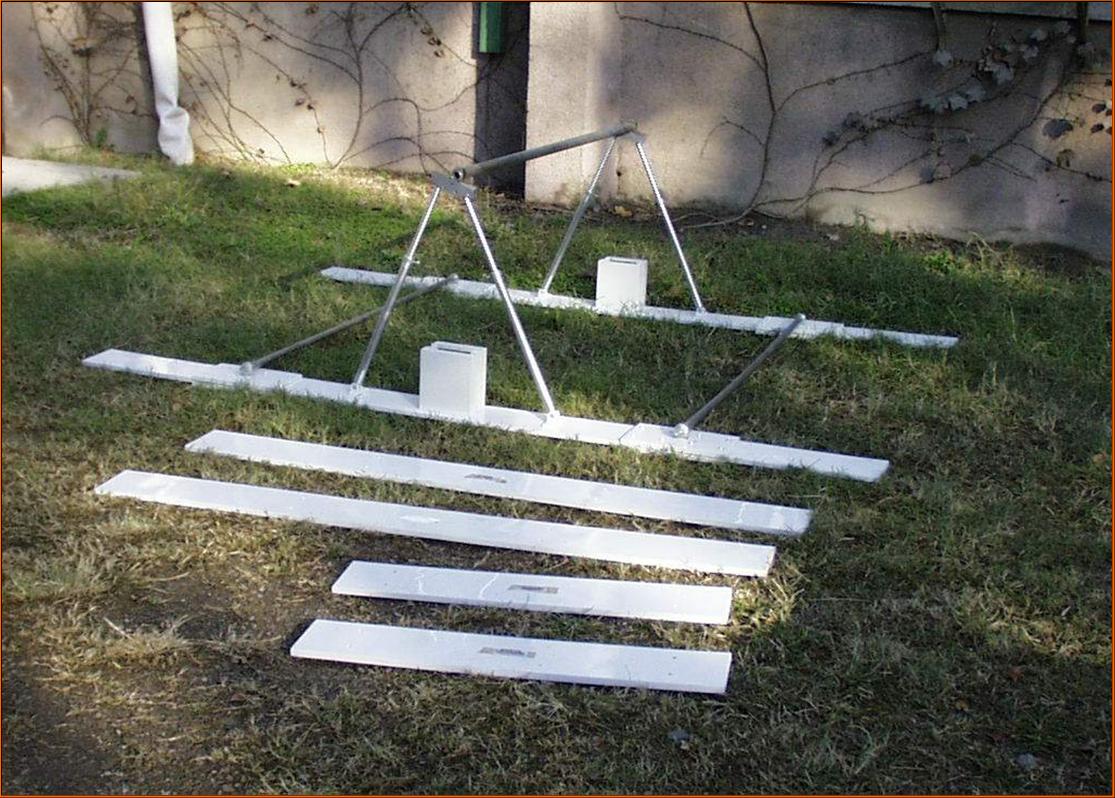

                            @valchev:
                            Can you post picture from antenna, please? Or a drawing?
                            • #89
                              Low cost GPR - Ground penetrating radar - 660MHz unshielded antenna
                              • #90
                                hi valchev,
                                the 660 Mhz, is this included in the package of 3500 euro?
